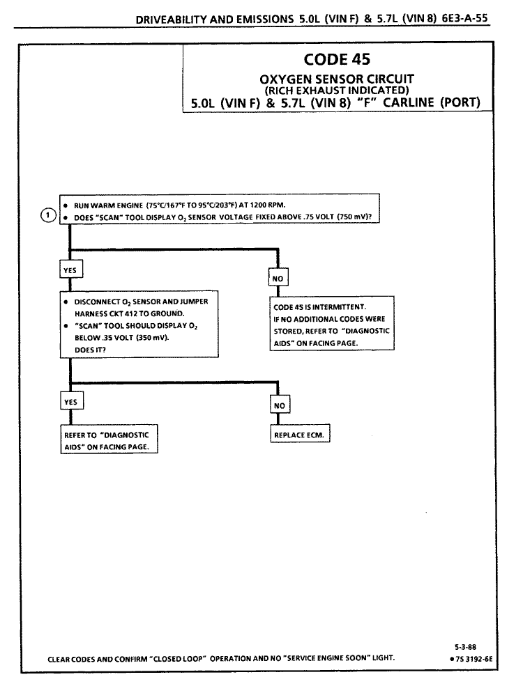

Trickster's Avatar
Posts: 6,127
Likes: 12
From: conway, s.c.
Car: 1989 Iroc-Z
Engine: 5.7L TPI
Try this and read the part about the "HEI Shielding"

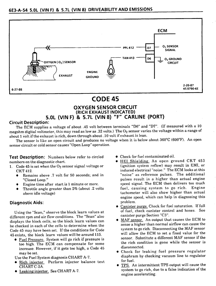

Old Nov 14, 2004 | 11:26 PM
Trickster's Avatar
Posts: 6,127
Likes: 12
From: conway, s.c.
Car: 1989 Iroc-Z
Engine: 5.7L TPI
and part 2
Old Nov 15, 2004 | 12:29 AM
A 9 Year Wait's Avatar
Joined: Apr 2004
Posts: 31
From: Kearney Nebraska
Car: 1989 IROC-Z 305 TPI
Trickster, you truly are a camaro guru.....Now that I've read the the pages that you posted, I went outside and checked my TPS. Upon inspection, I came to find that the darn thing wasn't even tightened down with the Torx Screws. I have never messed with the TPS since I got the car, and it has always run sort of rich...So now I'm wondering if it isn't the TPS allowing too much fuel to go through and making the ECM shut the car down...does that make sense?? I'm obviously not too patient or understanding of "computer" controlled cars, so the part on HEI shielding looks like greek to me. Anyway, let me know if you think it may be the TPS..
Old Nov 15, 2004 | 09:02 AM
Trickster's Avatar
Posts: 6,127
Likes: 12
From: conway, s.c.
Car: 1989 Iroc-Z
Engine: 5.7L TPI
The TPS is a good place to start with your problem. The voltage on it should be .54 volts DC + or - .08 volts. When the engine is running at idle, the voltage will always increase by .02 volts DC. Another good place to look would be you fuel pressure. You didn't mention what it was in your other posts. The fuel pressure should be no more than 50 PSI max. Even then, that is a little high for some systems. Check the ducting for the MAF sensor to make sure it is on tight and has no holes in it.
