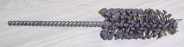

All the SLP runners are 1 5/8 since that is the stock size of our plenum, runners and base. Even Edelbrocks high flow TPI base part# (I think) 3860 is 1 5/8. I know this because I bought one compared it to my old one and they were exactly the same size. The SLP runners just have no center section so you can stuff a little more air in at the begining. The bottom runner I only ran a ball hone thru to clean up the casting a little the top is fully ported I am still polishing as we speak.

were do you get a ball hone?

I called around to some of the local machine shop "Supply" companies. this is a worn out one but it started out as a 3 inch ball hone and after craming it down the runners a few times the bristles shaped so it wasn't that big any more then as the stones wear down it gets even smaller but still works well.
