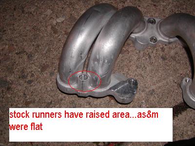

Well, I spent about 11 hours yesterday helping my friend install a set of as&m runners and afpr on his car. 11 hours you say?....Why did it take so long?
Well, first we ran into the problem that my T40 socket wouldn't fit inbetween the tubes on the lower side. So we went out and bought a screwdriver style T40 tool. Then we were having all sorts of problems getting the lower 4 bolts on the runners. Then I happened to notice his stock runners have a raised section for the lower bolts to go into. Since these bolts are only threaded half way up, they would not go in all the way on the runners. I figured that they would have to go in all the way so that the head would siton the runner to get a good seal.
So, I grabbed a few extra shorter bolts from one of my old tpi intakes and tried that. The problem with that is that there was no way to get the bolt all the way back into the small opening. So, we went to Home Depot and got some 3/4" tubing. I cut the tubes down and used them as spacers to accomodate the missing raised section for the runners. I used masking tape to secure the bolt to the t40 tool and the fabbed sleeve to the bolt. Then I inserted the bolt, threaded it a little. Took pliers and removed as much tape as possible and then tightened down the bolts as far as I could.
Problem being that it was a pita to even get the bolts in there, let alone to know if I was threading them the right way or not.,..and it was dark by this time to boot... So, I couldn't really see much of what I was doing, but I tightened them down and prayed that there were actually secure and that I didn't cross-thread.

How did everyone else install the lower bolts to the runners? Has anyone encountered the same issue?
Was what I did smart fabrication or a quick hack job?...you decide

My AS&M runners came with 4 special fasteners that I used where you had trouble. Maybe they should've been included with your runners but were omitted? They fit fine length-wise and used a 6mm allen fitting to drive them in.

The SLP runners I recently installed came with new bolts that had a center with a hex opening instead of a torx. They provided a long thin hex extension for the install.

Yeah...my friend bought it used with no hardware.....the correct hardware would have helped
