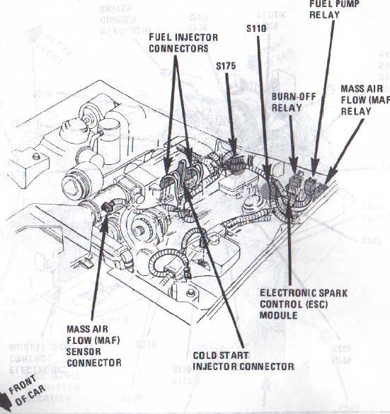

Thanks for the responses guys, I will give the relay a shot. Which one is it on the bank of 3 on the firewall?

Their is two MAF relays. One is a burnoff relay and one is a power relay. You can try changing both and see if that solves your problem. If not you will need to begin troubleshooting. The below image is a page I scanned directly out of my GM service manual. I hope this helps.
