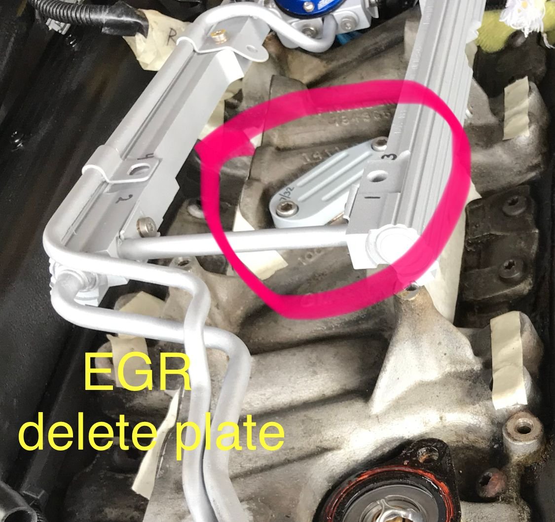

Old Oct 11, 2021 | 05:51 PM
Cam1992's Avatar
Joined: Jun 2017
Posts: 3
From: Dallas, TX
Car: 1992 Camaro B4C 1LE
Engine: L98 350
Transmission: TH700r4
Axle/Gears: G92
Re: 10088113 heads with a tpi
I blocked off the EGR on my '92 L98 motor. As for the PROM, you locate the car's computer, pull it from the pass. side, and gently remove the PROM chip. You'll more than likely get it sent out and have someone work on the chip. That's what I did (deleted the Vehicle Anti-Theft System--VATS while at it).
Or you could buy a new pre-programmed PROM off the internet.
1992 Camaro L98 EGR Delete Plate.
