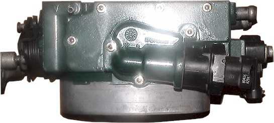

You can remove the plate, but you'll be shopping for a new throttle body shortly after you realize that the IAC stepper motor and valve also mount to that "junky" plate.
Penetrating oil, a little heat, and patience usually get the screws out - Even after they've been in there for over 20 years:
Be patient, and they'll come out. You can even scale this image up and make your own gaskets if you cannot find them at your Holden dealer:
