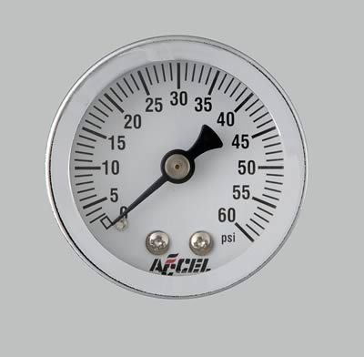

Alright,
I was at a car show last weekend and noticed a car that had a Chrome Plated TPI setup...
Well, I instantly fell in love with it and went over to look at it.
I noticed there was a gauge on the fuel rail on the passenger side.
Where can I buy me a gauge to put on the fuel rail fitting so I can just see the fuel pressure at all times???
Anyone got a link to a gauge that would fit and to an Adjustable fuel pressure regulator?

Yeah its made by accel there are two part numbers on summit.
http://store.summitracing.com/partde...5&autoview=sku

yeah but if you read the description of the item it said that its not intended to be permanently mounted up. I was going to get one but since they said that i want to know the reasons why you cant plus i even called into summit to ask, couldnt really give me an anwer so i just never got one then bc of that.

Mine has been on there for about 5 years, no problems.

I ran mine like that for a while too with no problems. I have since removed it and made up a small -4 braided line and moved the guage to the side by the heater blower motor. I didnt like were it was because it got in the way of adjusting my afpr. Plus mine came with a bracket to move the map sensor and I just didnt like the way it looked.

The reason for it being a temp mount is vibration. It is a very likely possibilty that the gauge will be wrecked from the engine vibration eventually. I know that's what happened with mine. The new one I bought to replace it ( inside mount ) even says it should be remote mounted, isolated from vibration so as to not damage the sender. I ran braided line to the firewall and used some rubber lined clamps to secure it.

I pity anyone who mounts one there and vibrations cause it to crack and spray fuel on the distributor. .... I would be more compelled to use a TBI pressure gauge setup that taps into the softlines and remote mount it off to the side of the engine. I think a few of us remember early TPI's with cold start feed lines leaking and spraying fuel on the distributor and causing fires.

I was wiping down my engine recently and the clear plastic cover came off, it snapped right back on, but I am sure the vibration and heat are not good for it. I will be changing mine soon also.
