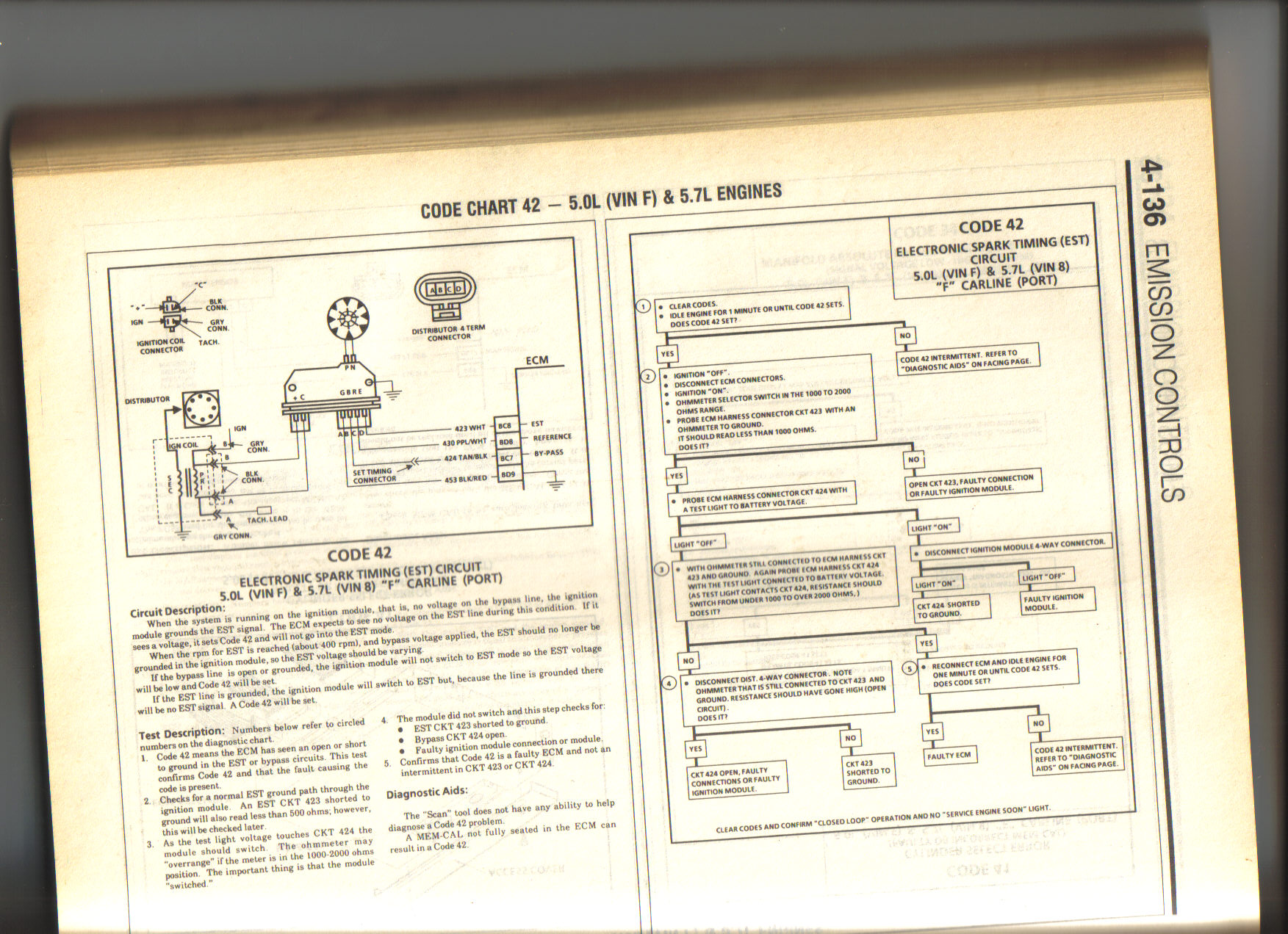

Here is a chart for the code 42. Should get you going in the right direction.

Replaced, and all is well.

Interesting! I have a 305 TPI that I've been trying to get to run smoot with ALDL (ECM) pins A & B jumpered (Service Mode). My symptoms are exactly the same as you describe. it will run for a bit during acceleration, than BAM!, it will jerk and sputter. I have a new ignition module, I think I'll put it in. Have you also replaced the Pick-up Coil? My ignition module and pick-up coil are in the distributor. are yours?

Yes, I have the small cap HEI as should you. This distributor is actualy one I picked up from a friend, and sent it to the guy finishing my car.
I would replace the ignition modual and see what that does, sounds like you have the same problem as I did.

had a friend with this issue. We replaced the distributor because the wires on the inside of the distributor were corroded going to the ignition module. Fixed it right up and no problem since.
