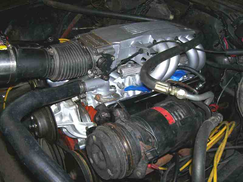

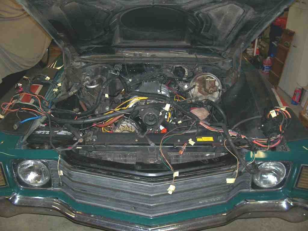

Re: putting tpi on a different engine
Originally Posted by IROCmatt
will tpi only run on a engine set up for it, or can i fit tpi on to a engine that should run a carb? as im trying to get hold of a new engine and want to keep the tpi.
Probably:
Do I smell a bit of sarcasim....... you gotta admit the tpi is one of the nicest looking efi systems ever made.
