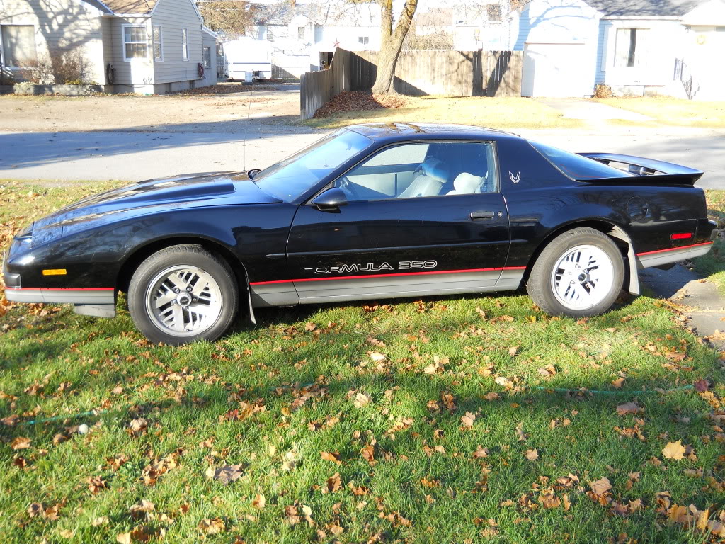

here is the bird i just picked up for 1400 bucks
