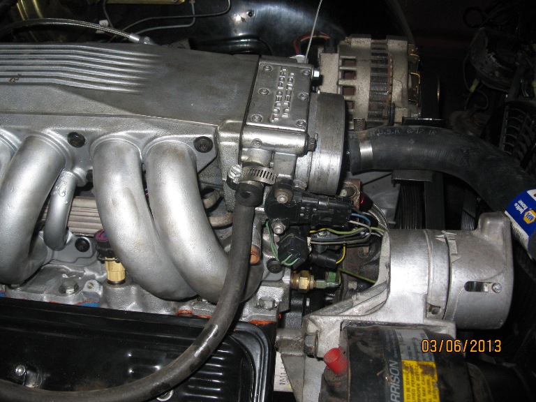

Can you post a pic of the line from cover to the T-body? It should be going to the top port on the pass side. That vents to the top of the T-body infront of the T-body blades.

The line from the passenger side breather to the tb is hooked up on the 2nd port from the top on the passenger side. I have the same motor in 2 other cars hooked up the same way.

The pass valve cover line is supposed to go to the T-body top port. That will make it work properly because its pulling fresh air from the front of the throttle blades. The 2nd port down pulls vac just like driverside pcv line going to the plenum because its behind the throttle plates.
The 2nd port down is supposed to go to the EVAP vapor canister.
Your other 2 cars are wrong also but the motors could be loose enuff or gaskets are leaky so that it isnt a problem.
You could block the 2nd port down and put a filterd breather in the pass valve cover.

Makes perfect sense and you are correct. I went out and swapped the lines and the whistle is gone.
I owe you some beers if you are ever around northern jersey.
All my motors are set up the same way (wrong). I guess they are just so loose they don't whistle. The hose coming off the breather was smaller than the nipple on the throttle body. That was why it was on the lower nipple it fit better .I figured it must go there.
