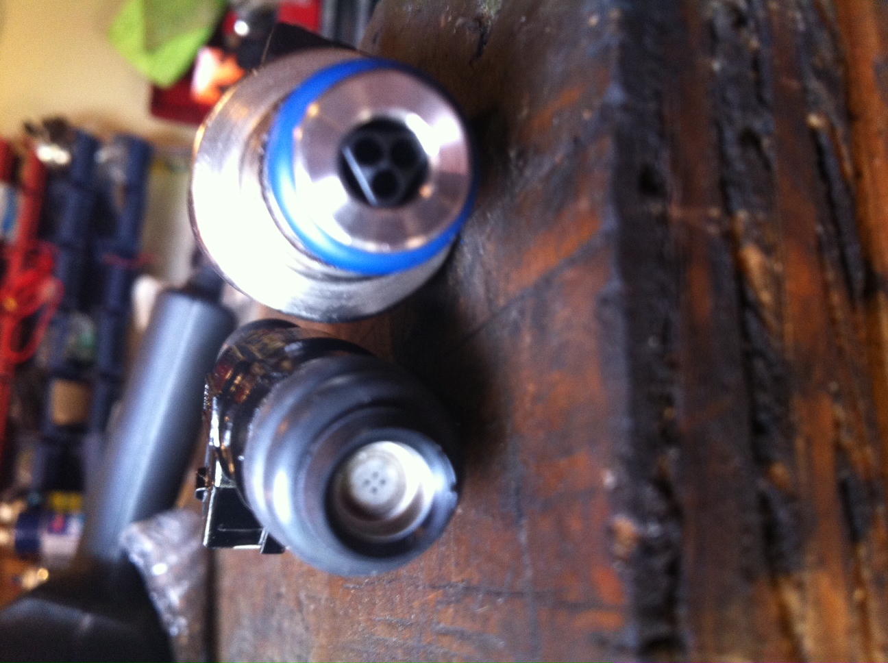

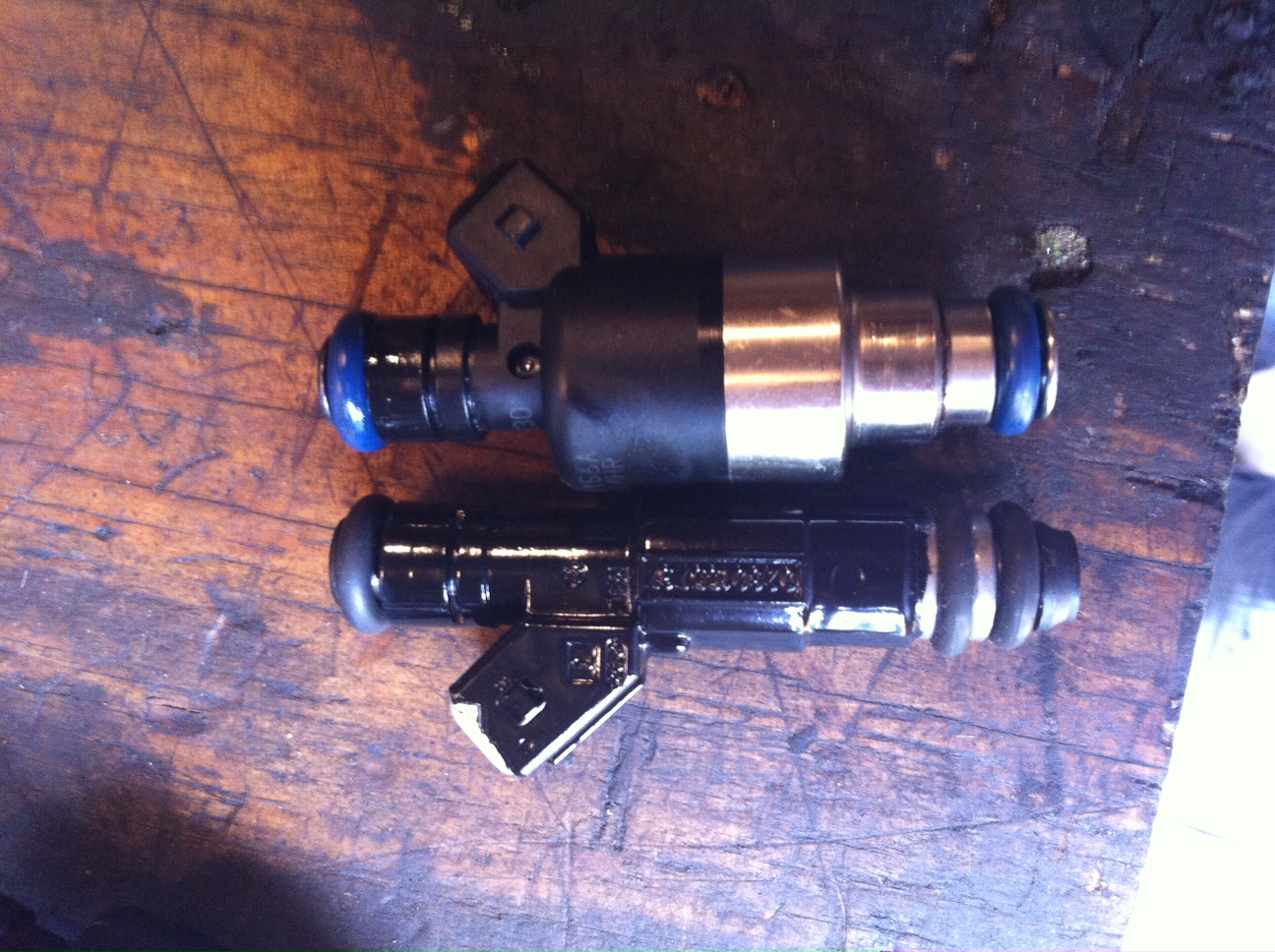

I plan on taking a few pic's this evening and compare them to my Holley injectors. From what I have read you need the adapter or an extra o-ring on the bottom of the injector for a TPI intake. Since I have a HSR intake. I wanted to post some pic's if the extra o-ring is needed or not.

Southbay is right,
With the extra o-ring on the bottom. The fuel rail wouldn't line up with the bolt holes. I pulled the o-rings off and the fuel rail sat right down into place. No spacer or o-ring is needed for HSR intake.
It really likes those injectors, I am having a few issues though I hope to figure it out this weekend.
