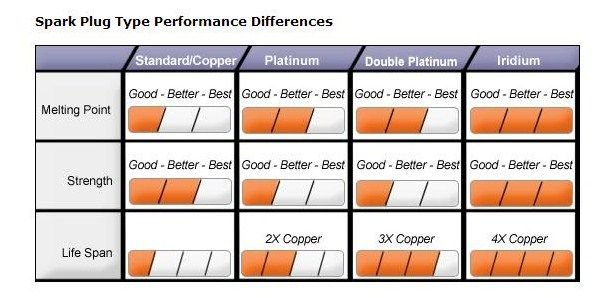

Re: Spark plugs for 91 5.0
Iridium Is The Best,But Also The Most Expensive.

Nothing to be gained unless your current parts are failing. ACDelco still offers the R43TS - R45TS the car came with, and short a longer service life, you're not gaining much by using a more expensive plug.

I've been using NGK Iridium plugs for over a few years with no issues at all. In fact, I used to use Bosch Platinum and will never go back to them.

Plugs and wires are generally good for a lot more than 15K miles. Some for over 10years and 100k miles (I don't recommend this) if you keep all other systems up so you are not burning oil or rich/lean.

Yeah same here. Works just fine. I think the "performance plugs" are snake oil for the most part.
