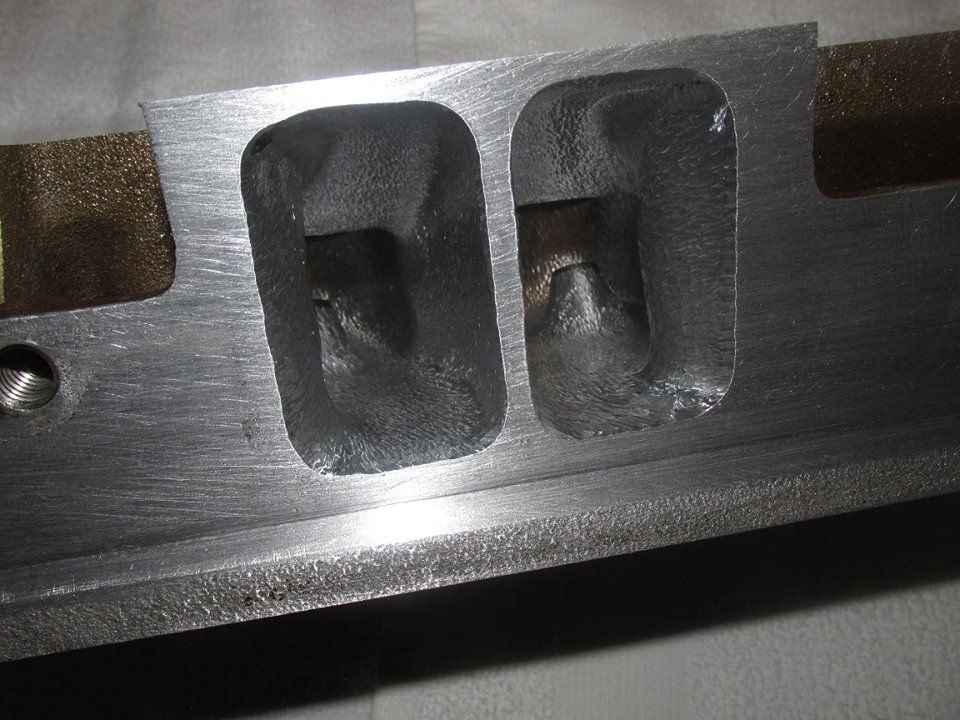

Doing a project for myself. '86 IROC with a '91 L98 engine. Decided to port the heads and use a mini ram. Converted the heads to 8mm 2.00/1.570 valves and used a LS drop in kit. Erson 226/234 camshaft. Should be a nice little fun ride!

Nice, did you get any b4/after numbers on any of it? I did a set of 113s almost 20yrs ago and we picked up 6/10ths in the 1/4 over the stock 87 350 iron heads.

Right off the car to the bench .100-.700 on 4.00 fixture
Reworked with 2.00/1.570 .100-.900 on same fixture
NO PIPE on either

How much does that texture on the intake side help? Never seen it before. You still post on the bullet?
Yes, still mess around on the bullet.
texture is voodoo..
