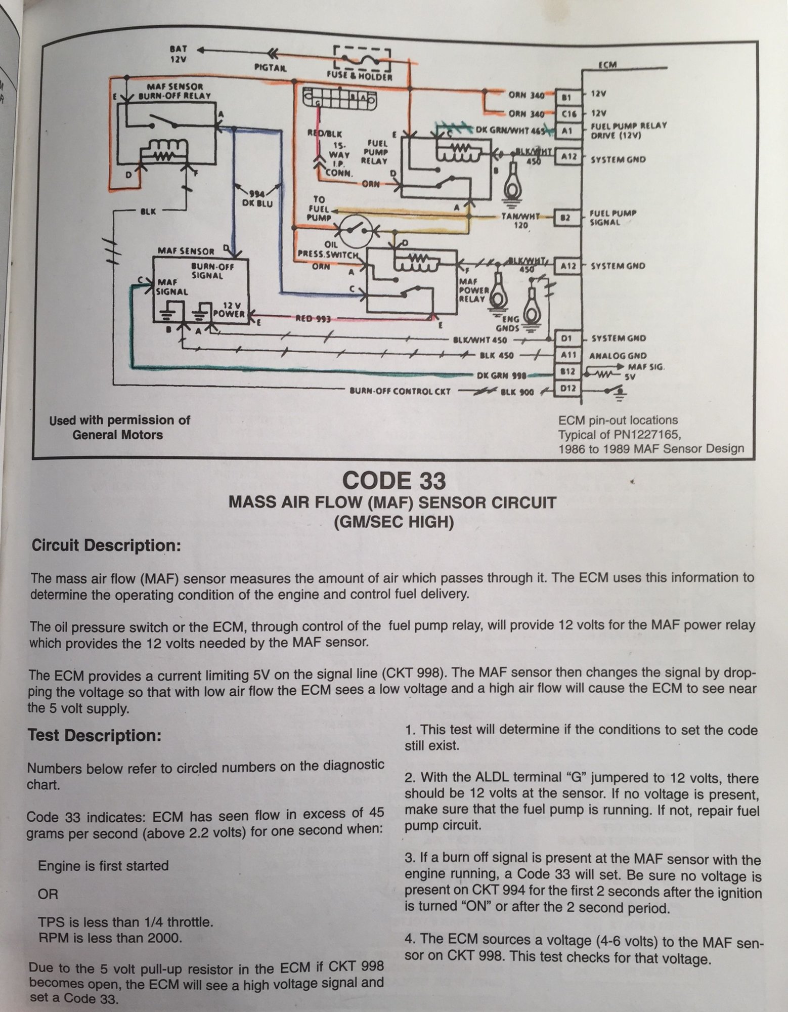

33 is maf grams per second high.
post 2 explains what triggers it.
https://www.thirdgen.org/forums/tpi/...de-33-tps.html

Driving down the highway today with no engine light (intermittent) and suddenly I had a complete loss of power, no throttle response at all. After about a second or two of zero power the car went back to normal, but the engine light lit up just after that, while I was driving. Does this give any hints as to what my 33 and 34 might be?

Re: Intermittent check engine light. Maf? Need help.
could be wiring issue, maf power relay or connections or bad maf or even ecm.
You should try the trouble tree.

How to I get ahold of a fused jumper? Can I make one?
Use female spade connectors wire and a fuse. I would guess 5amp would be fine.
After connecting the junper to ALDL G could I connect the other end to the fuse labed BAT and use that as my 12v source?
Some aldl don’t use G. Yes it would be a positive wire to the battery. The alternative is to backprobe the relay terminal d.

Do any of you guys have experience with making and using fused jumpers? Tuned Performance said just some spade connectors and a 5 amp fuse. Would I have to get a fuse holder then extend the wires, connecting one to the battery and one to the ALDL/ OBD1 port G? I am just making sure I don't mess up and fry everything.
