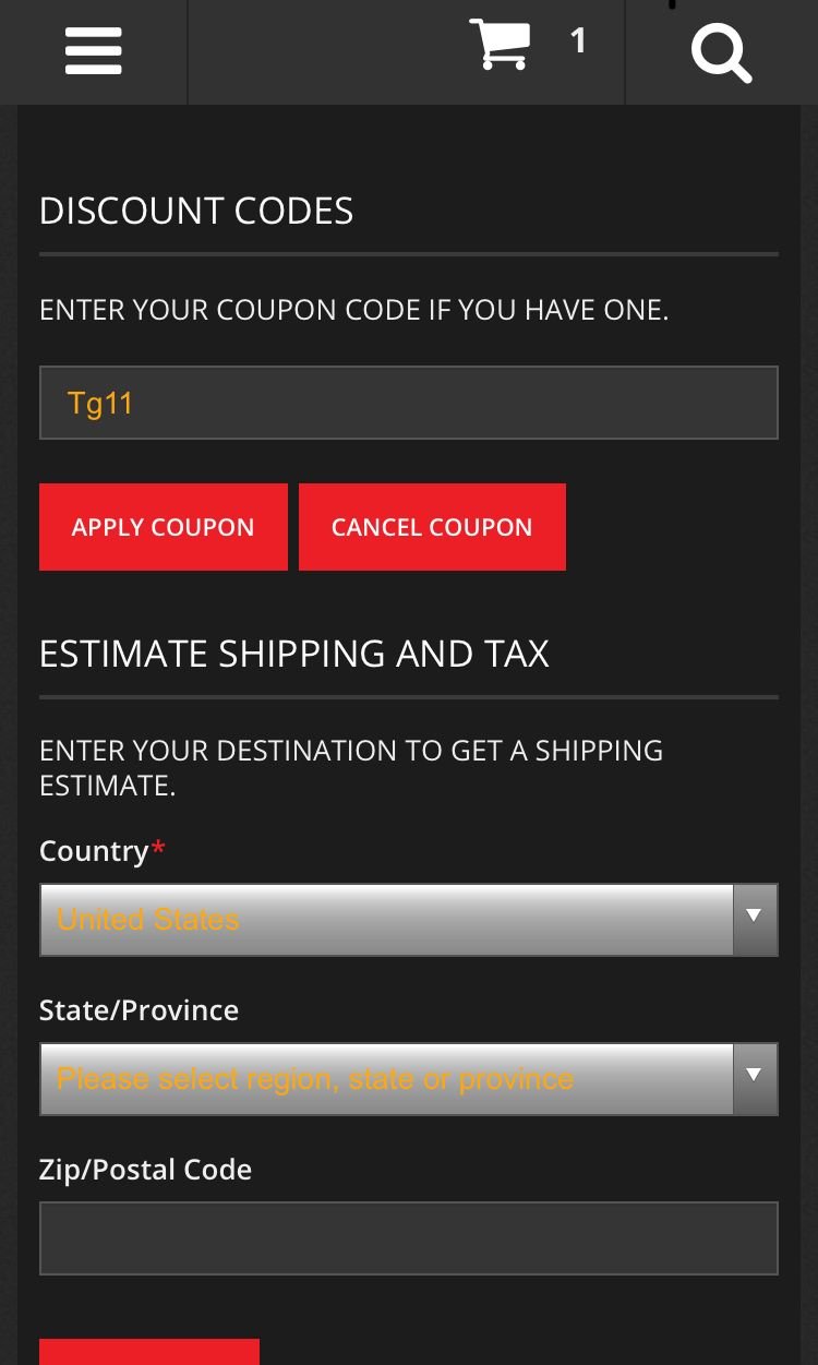

I ordered a set today on their website, but I didnt see where to put in a promo code. But, at least they're ordered. Thanks again for the help!

It shows up after you put the item in the cart.
