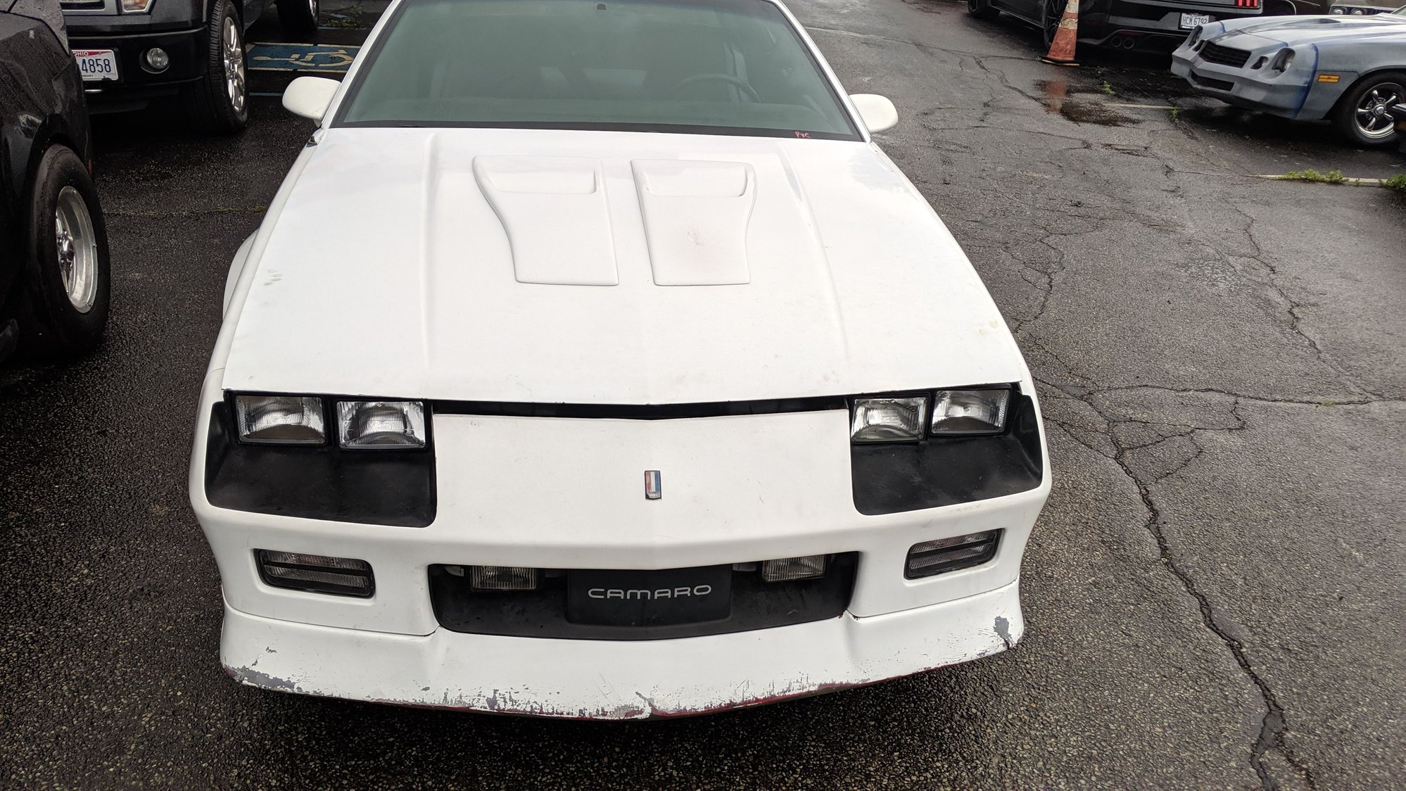

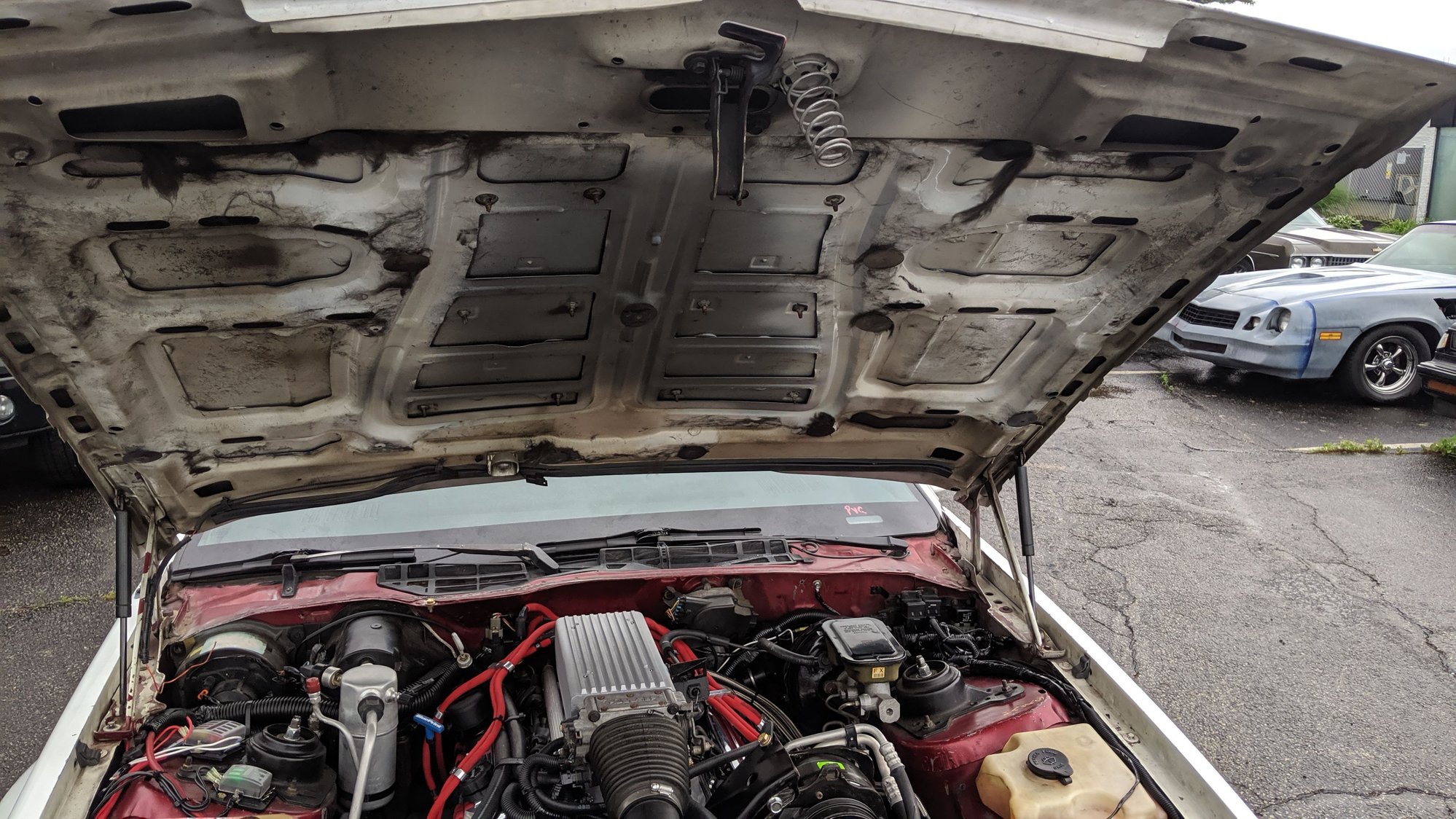

I'm in enclosing pictures of what's going on for me. I'm not entirely sure there's anything I can cut to make it fit.
This is as far as the hood will close.
And this is the underside of the hood.
I can probably still cancel the hood I bought if I can figure out how to get the hood to shut.
Here's a picture of the finished product if it helps.
Thanks for any help.

I had to cut my 89 iroc hood. That center circle piece that sticks out i believe touches the throttle body side of the intake and if you cut it out it should clear, but mark and see. Piece of clay or something
Old Jun 10, 2019 | 08:44 AM

Sort of the same thing here but with an RPM Air Gap/carb/14" x 3" open filter.
I had to slice away a few choice bits of the underside bracing and that left just enough room for the hood to close.

Thanks guys. I believe you are totally right The clearance issue is in fact where that round black plastic hold down is.
I have just cancelled the hood I ordered I'm going to try removing that before spending $800 on a new hood.

Additionally I mistakenly ordered 72-81 Camaro engine brakcets since my originals were pretty grungy as well as installed poly mounts.
I think the brackets and poly mounts raised the engine up a bit causing the clearance issues.
Based on feedback from the posts in this thread, I had the hood altered to remove the area highlighted in blue in the image below. Now the hood closes with 1/4 inch to spare.
