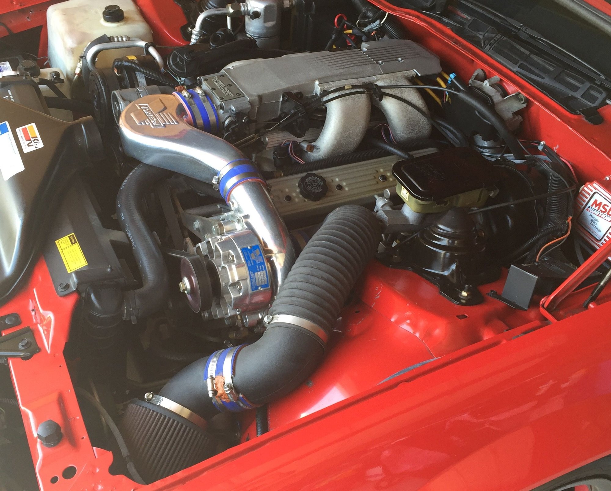

1991vortech335's Avatar
Joined: May 2016
Posts: 31
From: Canada
Car: 1991 Convertible Z/28
Engine: Vortech 335 TPI
Transmission: Trans-Go 700-R4
Re: Powerhouse 335 stroker
Originally Posted by Acceld Z
My bad I'm with you guys on building the 305's. It's what's in the car, go with it. Has anyone ever built a 335ci TPI engine?
I have and I have to tell you when it's all said it done, this thing goes! Yes it's polished in all the right places and while there are always faster cars out there I've yet to really come across very many. Build it right! Get an internally balanced crank and rotating assembly and have it all balanced to the very tightest of tolerances, don't overcam! Don't go for super big compression if you are going supercharged like I did. You would be surprised what "doubling" under the hood does to these third gens! Building hp is one thing but you have to consider building a tranny to handle it, a rear end that will stay together, a tighter lower suspension to stick, frames to be connected ect. Take your time and enjoy building it up and I personally can say from my own experience that my 335 TPI is my favourite engine I have had! PM me and I can give you more build up info if you like.

Boost makes anything fast.
9 psi made my bone stock 305 tpi auto go 13.4 at 110 mph. Thats 20 mph more than what a stocker should run
If you are boosting you dont need a stroker 305.

Why is the stock air filter box still on lol?
Originally Posted by 1991vortech335
