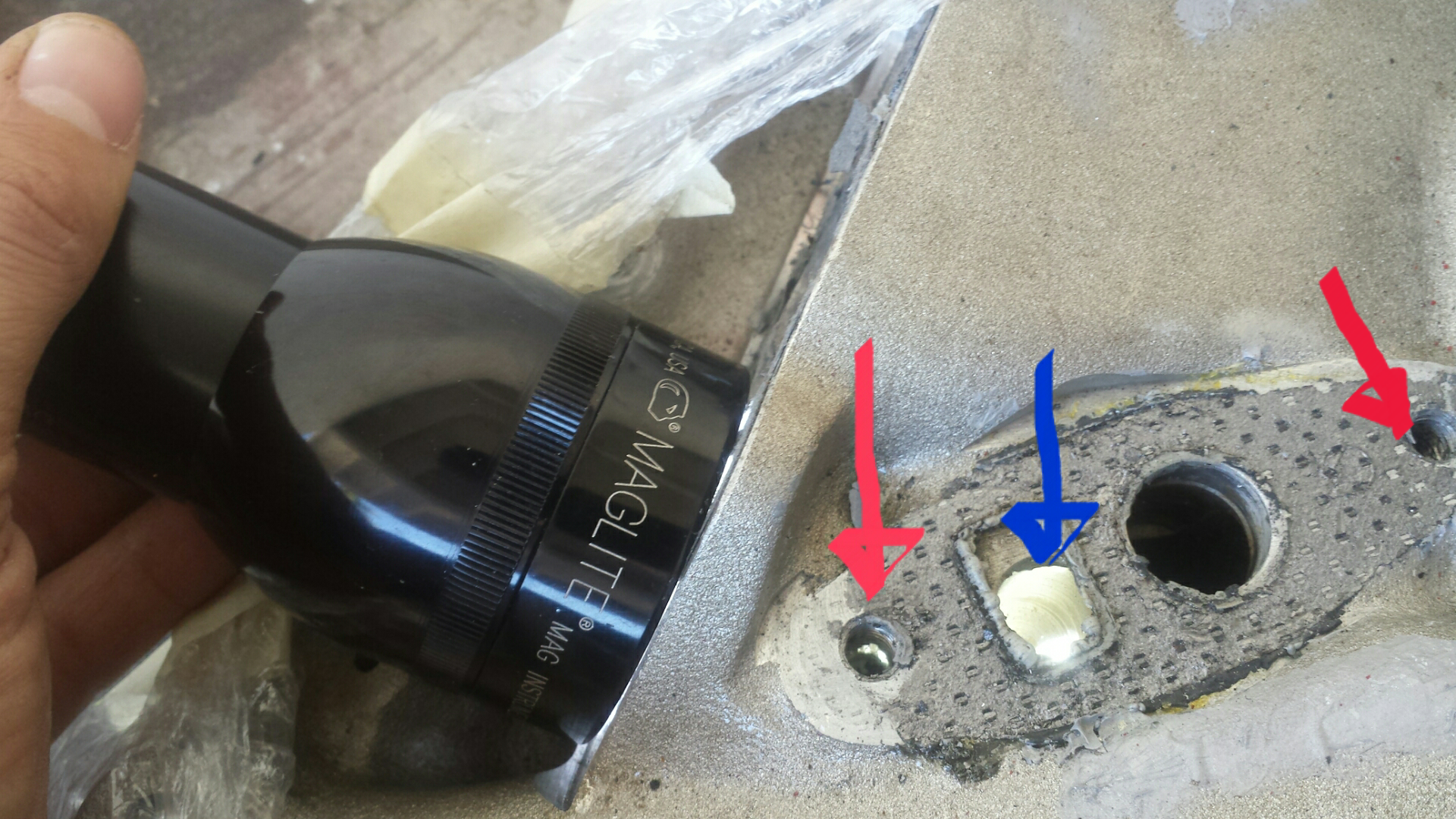

ok. So, I had some time this weekend to try to find why my car was running bad at cold starts. I was hesitant to take out the intake manifold all over again, but i did it anyways. As you can see in the picture I shined a flashlight thru the side of the intake at the vacuum port and notice bad workmanship done to this intake. The red arrows show where the vacuum leaks were coming from. They drilled the egr vacuum ports too close to the egr bolt threads creating a passage of vacuum. Story of my life! Anyhow I end up porting out the stock intake manifold and installed it back in the car which run awesome again. I don't think I'll be using this edelbrock intake anymore, who's know what other imperfections in might have internally. Too bad since I have the edelbrock runners and headers to match it up. I do thank all of you for your input though.

How did you find the leak ? Carb choke cleaner ?
the only flaw I’ve seen on a batch of the edelbrock bases is where a runner bolt connects to the coolant passage. Not a problem to use the base you just need to use liquid Teflon on the runner to intake base bolts.
you got it, I used carb cleaner and BINGO! rpm's went up when I sprayed at the egr bolt.
