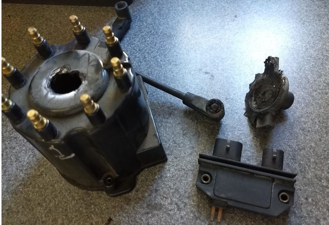

Re: 1991 Z28 305 TPI will not start
Here is a pic of melted parts.
Reply 0
