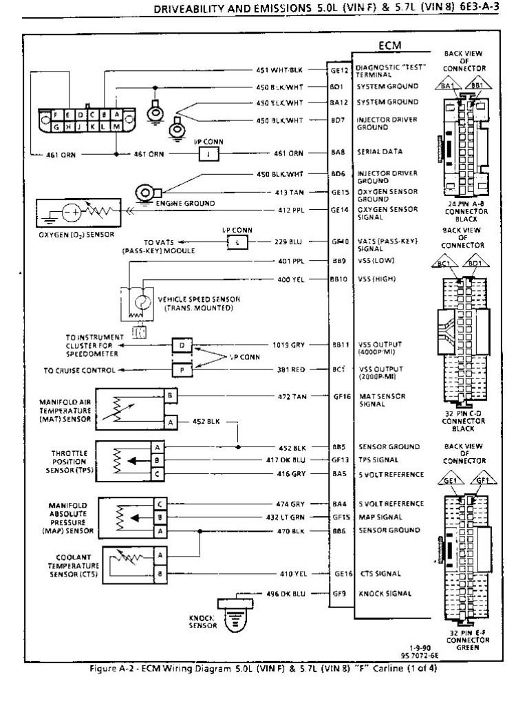

Old Aug 20, 2020 | 06:56 PM
Dirty_Duke's Avatar
Joined: Feb 2020
Posts: 126
From: Oregon USA
Car: 91 firebird formula ws6
Engine: TPI 305 (R6P)
Transmission: R6P t5 5 speed
Axle/Gears: 3.42:1 Posi Diff
Re: Code 33 and stall 1991 LB9 305 tpi
I will try to use this diagram, but I'm having some issues using tuner pro rt to retrieve data. Also i have a Chilton's and Haynes manual what is this diagram from? I couldn't find anything in mine. And tuner pro rt isn't displaying gauges for some reason after I load the adx file and without gauges I can't see what my car is doing.
