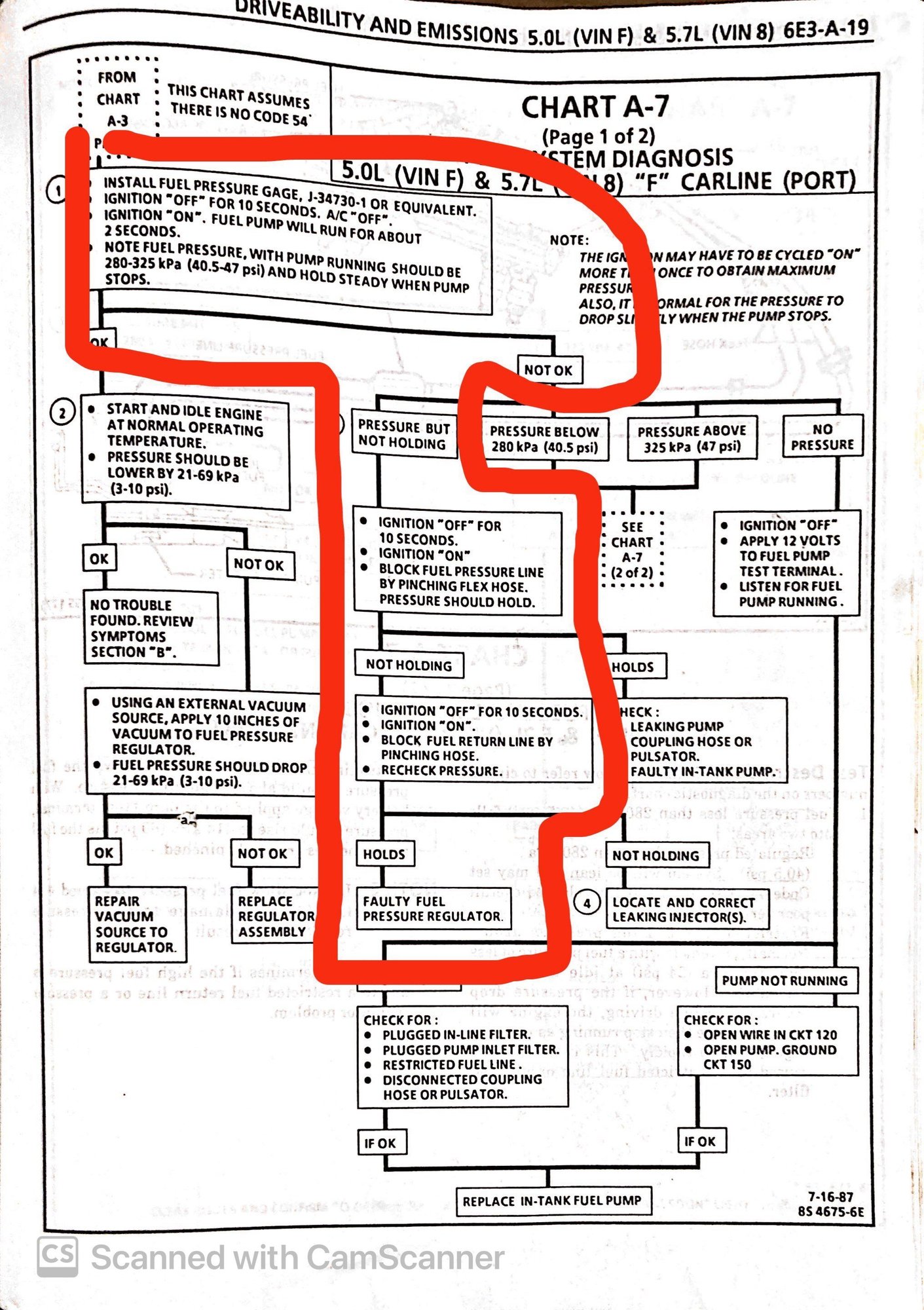

So I hooked up the fuel pressure gauge and immediately noticed when the key was in the on position the fuel pressure drops after the 2 seconds of pump operation.
I started the engine and the fuel pressure was great. I shut it off and it immediately began falling pretty fast.
So I followed the diagnosis chart on this and it ultimately led me to a faulty fuel pressure regulator.
It makes sense with what the fuel pressure was doing when I pinched the return line it held solid at 40 psi. as soon as I released it it dropped to 15psi.
The previous owner had replaced the FPR a couple years ago but it just goes to show you cant trust anything you haven't fixed yourself. The FPR was the only thing I hadn't looked at.
Thanks for all your help guys. I'm thinking this should fix my rich condition.

Fuel pressure after shut off is meaningless. Fuel pressure only matters when it's running. This is not your problem. Will not fix anything.
GD
