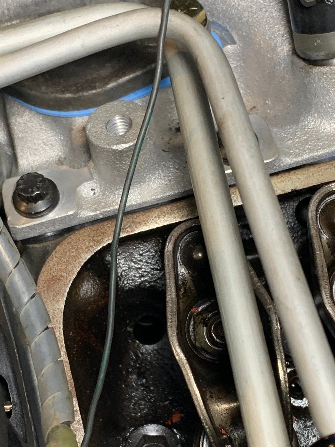

In the process of trying to get my vortec tpi build running. Currently dealing with a no start issue and possible fuel injector issues contributing to that. While working on it last night I couldn’t help but to notice a large gap on the driver side intake manifold which made the gasket look loose. I was able to take a flat head screwdriver and actually move the gasket, this is towards the rear of the engine while the front looks nice and compressed under intake. Feeling in rear of motor I can also feel a gap between the manifold and block where you apply rtv and it seams like an amount that can’t be made up to seal this intake. Any advice on what can be done in this situation? I may be pulling the rail for new injectors and can pull intake at the same time to try and reseal but idk if it will.

Back with an update on this issue. Pulled the intake this morning and also pulled the oil pressure sender adapter, reinstalled the intake and torqued to spec and no more gap on the driver side gasket. Looks like it will seal fine now. I did however install it incorrectly, the vortec oil sending unit adaptor interferes with the manifold when torqueing it in place. I missed this as I tightened the intake and that's what caused the intake to not sit flat. I now have another issue with the intake due to my incorrect installation procedures which leads me to ask for any insight on the possibly issues this intake may run into by just sending it. My thoughts are to jb weld the crack and sand it down enough for the runner to sit where it needs. I have it in the machine shop now and will be looking for a product to try and put on the intake before i take it home and start to put back on. The underside of the intake has no cracks only what is shown in the photos. Thanks guys any input is appreciated.

Got an aluminum welder near you? They can probably repair it fairly easily without too much expense

Have it welded and milled or throw it out. There is nothing in a tube that will help that.

He's right though. Mind you, I do disagree with the throwing out part, but I would definitely consider having someone weld it. Have someone, or yourself if you are experienced, dremel the line of the crack in the aluminum, then have an experienced welder tig weld the area shut. It's not difficult to do, an experienced welder can fix that small of a crack in twenty minutes...

Oh forsure it’s the best way, no questioning that at all. Def not throwing it out tho I’d drive it to that guys house with this crack before I ever just throw my money away.
