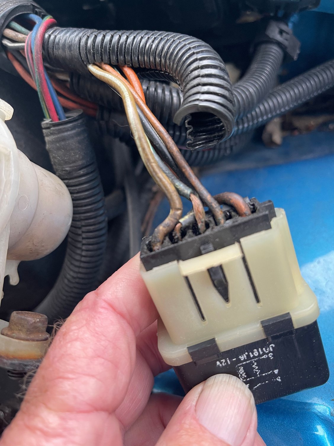

Well..new problem. The IROC is having trouble starting cold. Playing with it this morning, it’s setting a Code 34....MAF low.
They do this if the reported airflow is below a certain threshold. A few things can cause this:
MAF relay
MAF burn off relay
Wiring issue to MAF
MAF dirty (usually because the burn off relay isn’t keeping the heated wire clean)
Bad MAF
The last one is bad news. Bosch made the OEM MAF, and they’ve been discontinued for many years. Many of the ‘remanufactured” MAF’s are poorly redone, and pretty much anything out there no longer uses the heated wire setup to operate, which can cause all sorts of interesting problems on TPI systems.
The OEM MAF works by heating a wire placed in the airflow of the MAF. Since ambient air temperature is known by the temperature sensor in the plenum, the amount of current required to maintain the heated wire’s temperature is used to infer airflow through the MAF. More current required=more airflow.
I’ll start out by getting some MAF cleaner, and a new MAF relay and burn off relay. Those are the simple and cheap things to start with.
Who makes the best MAF these days? I see Delphi now has AF10320 available...but from what I understand, it’s not a heated wire MAF like the original Bosch MAF.

An example...I replaced the burn off relay, and cleaned my MAF, and seemed to have solved the code, but within a day, the car became hard to start. I decided to get out the fuel pressure gauge, and found that the system wasn’t priming at key on...a little while later, I found the problem.
