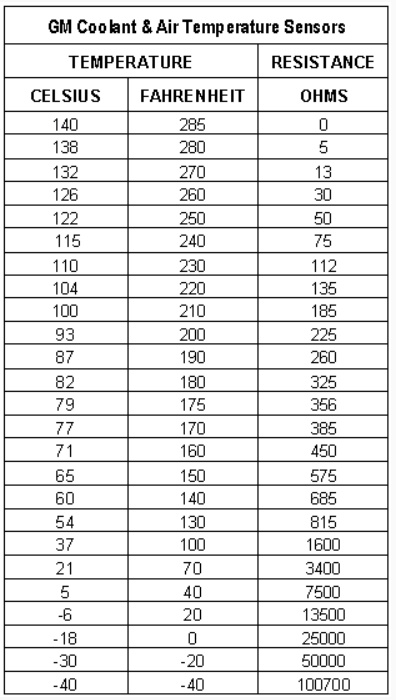

Ok folks I have a newly acquired ‘88 GTA with 350 TPI. It seems to be running rich. I installed a new Delphi MAF sensor as it was getting a code 34 and that seems to have fixed that for the moment. Next on the hit list is it seems to be running rich. I planned to replace the O2 sensor but was speaking with a mechanic buddy that said check the coolant temp sensor. I pursued the board here and found the ohms chart that matches to temps and set out to check that. I keep my garage at 58deg and the ohms reading was 4,520. According to the chart I would say meh not bad. So where should I go next?
