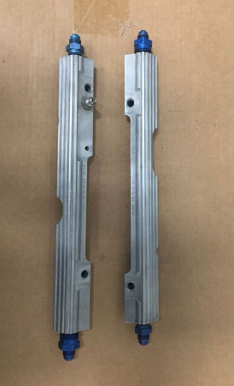

If interested I have this for sale or I think I might have one tapped npt but im
mot sure what size to tap the crossovers are 3/8 it might be 1/4npt to an6.

Looks like these could be 1/4 and 3 3/8 npt to barb

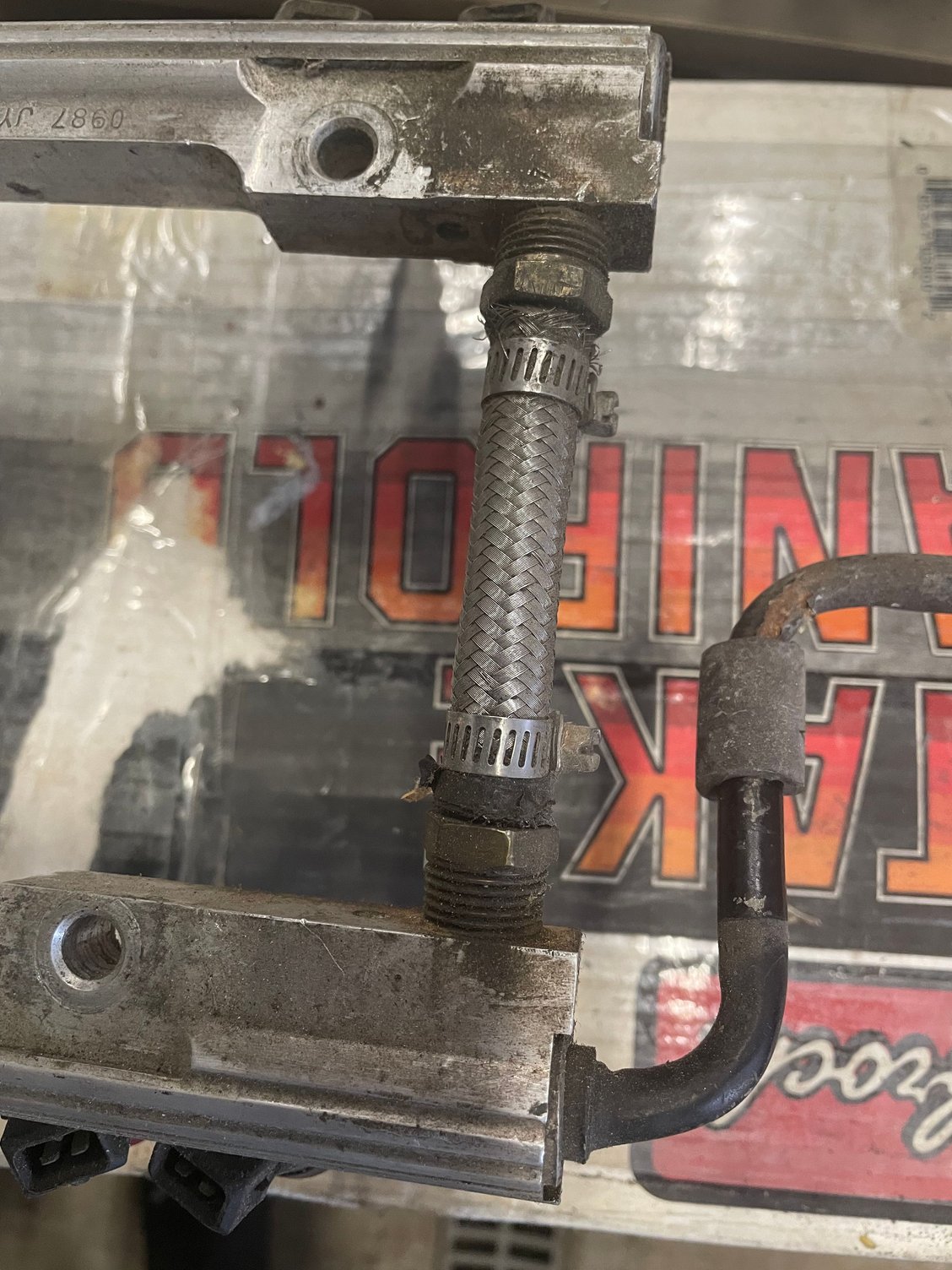

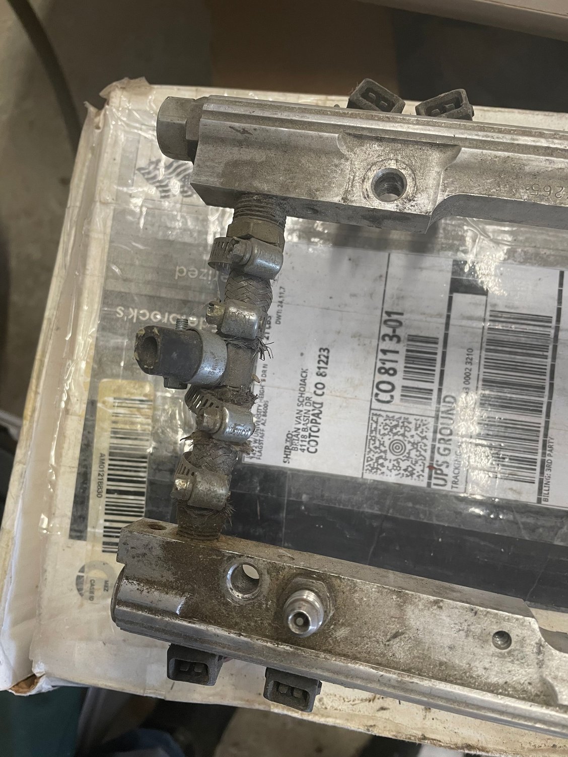

mine is currently set up like this. i thought it might be factory. i bought the manifold second hand. i didnt want to use rubber hose and clamps for the cross overs. i am planning to use an fittings and the braided line. so -6an is about 3/8. what about -8an?
Old Jan 29, 2022 | 06:52 PM
Tuned Performance's Avatar
Community Influencer
iTrader: (95)
Posts: 16,895
Likes: 1,014
From: Mile High Country !!!
Car: 1967 Camaro, 91 z28
Engine: Lb9
Transmission: M20
Re: fuel rail thread sizes?
-8an is 1/2
