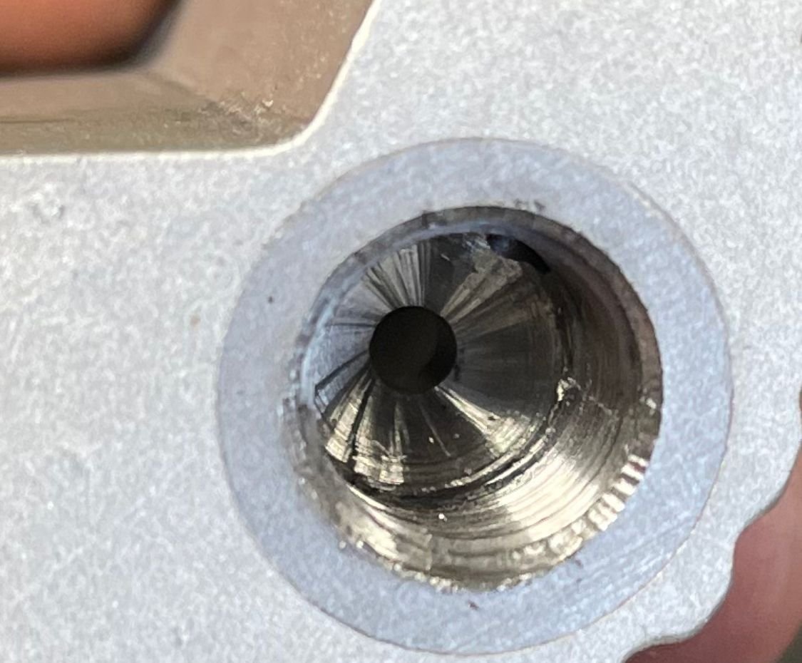

Originally Posted by ericoo1
It doesn't seem that anyone really cares, but maybe someone will be looking for this information on how to do this some other day. Here's the opening, hard line cut, and cleaned up with a 1/2" drill bit. I'm thinking about drilling the .100" hole to match the .300" opening, taping the hole and plugging it.
What did you ever find out many years ago with regards to the center hole in the fuel rail? I'm about to drill it out completely, lol.

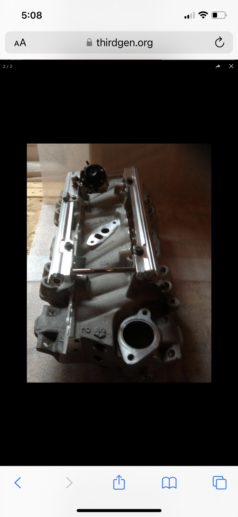

Re: modified fuel rail?
Here’s a picture of it. Saw no issues tapping you can’t tap to deep but I got to deal with npt.
https://www.thirdgen.org/forums/tpi/...uel-rails.html
ok awesome. So this circle is the restrictor ?
I’m not sure , the feeds on the rails I’ve seen have a slightly crimped piece raised up.
was this filed down and tapped too ?
yes. I put it on the mill and shaved it flush. Then I drilled it out with 1/2” drill bit I had it tapped at first with 1/4npt but my fitting wouldn’t go in as far as it should have so then I drilled it out to 1/2” and I’m going to tap it for M14x1.5 fitting to -6AN

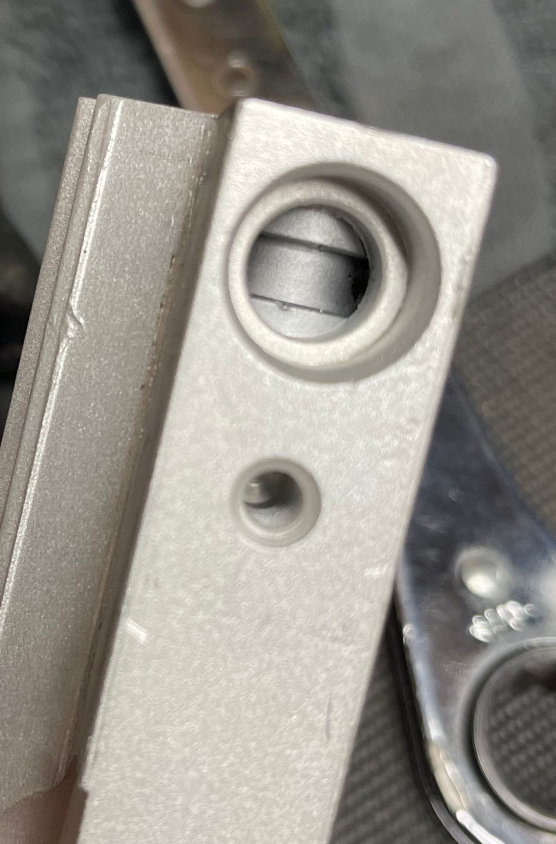

Looks like it’s steel. The round part sits inside the aluminum rail. When that’s pulled out it looks like it will leave a 3/4” hole. Is that correct ?
Here is what it looks like from bottom
Yes that’s the restrictor. You might try removing. The crip and press fit should hold under pressure but now the crimp is gone not sure I’d trust it. I’ve always heated it up and removed.
so in a nutshell I can just remove that entire metal ring which is the restrictor body ? That will leave 3/4” hole which I can use an adapter to fit my -6AN
I believe so, I can’t recall the restrictor depth it yeas could drill it out. I’ve see people leave it in and tap like yours and be fine too.

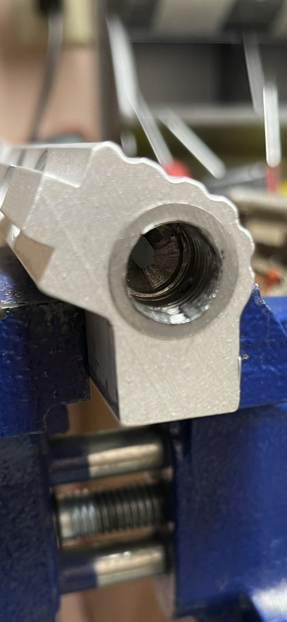

Just this, I bought a eBay ninth injector hole feed to an6 drilled the regulator body deeper and tapped to 1/4npt I think I’ve done a few for costumers but it’s been along time ago so don’t remember.
that fitting looks large. The OD looks at 3/4”.
