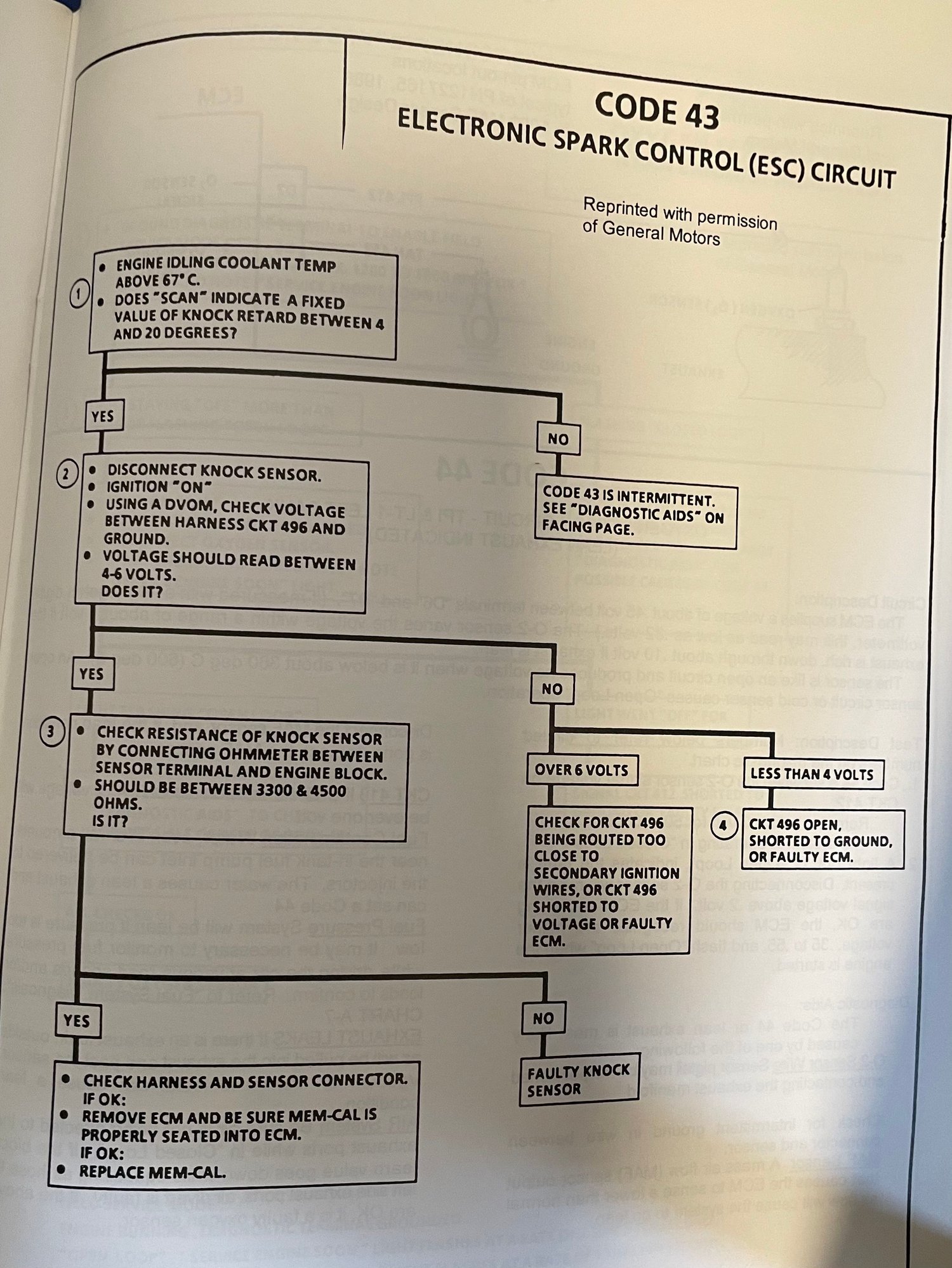

I have a 1989 Formula 350 TPI. Check engine light shows code 43. Bought 3 different knock sensors. Still have code 43. After looking at several forum posts, I see there are 2 different sensors, a 3.9K ohm and a 100K ohm sensor. All 3 I purchased were 100K ohm. For test purposes, I installed a 3.9K resister in place of the knock sensor and code went away and SES light turned off. I cannot figure out how to order the correct knock sensor The last two I ordered were one for a 350 and the other one was for a 305, both were 100K.. Does anyone have the part number for a 3.9K knock sensor? Thanks This car is kicking my butt.

Are you sure your cars not a 90 ? The knock filter is part of the memcal. The ls
ks wires directly from ks to ecm. Could be a faulty ecm or connection at ecm have you followed the troubleshooting guide ?

So can I still use the Troubleshooting guide you posted ?
Old Feb 6, 2022 | 10:41 AM
Tuned Performance's Avatar
Community Influencer
iTrader: (95)
Posts: 16,916
Likes: 1,016
From: Mile High Country !!!
Car: 1967 Camaro, 91 z28
Engine: Lb9
Transmission: M20
Re: KNOCK SENSOR-1989 FORMULA 350
Yes your using 90-92 parts 3.9k ks

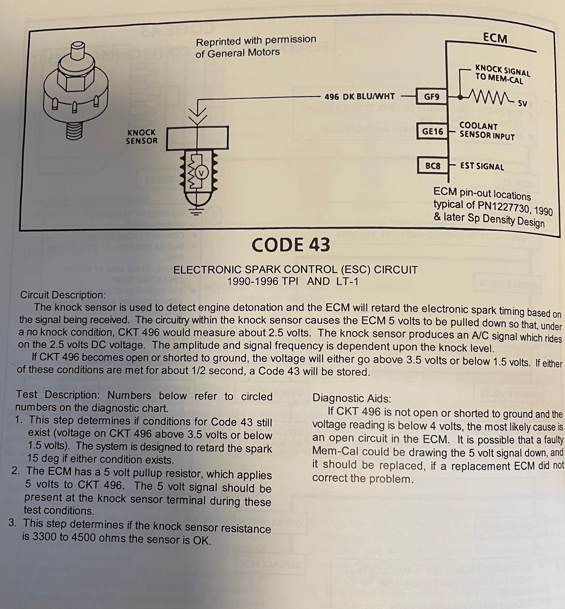

1 more question, how do I find the pinout for all the connectors on the ECM? Example CKT 496
Old Feb 6, 2022 | 11:07 AM
iTrader: (95)
Posts: 16,916
Likes: 1,016
Engine: Lb9
Transmission: M20
Pin F9 at ecm
its labeled there
https://tpiparts.net/1227730_pinout_diagram

Ok, Problem went away. I replaced the knock sensor with the 3.9K sensor and check engine light still came on. unplugged ECM and checked continuity from sensor to Pin F9 on ECM. Perfect there. Put everything back together and haven't had a problem since. Looks like maybe just reseating the connectors solved the problem ?? Thanks for all the help!!
