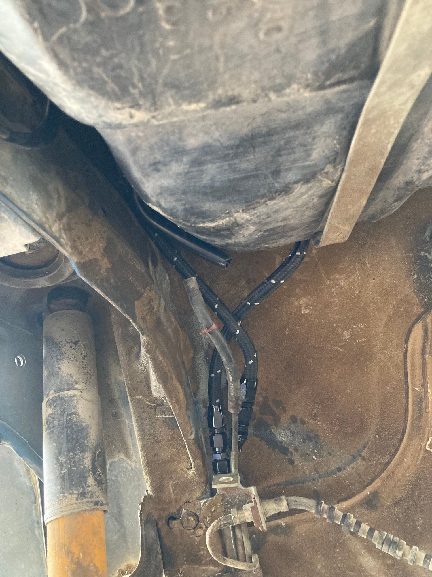

I actually just did this two days ago on my 99-02 plastic tank swap in my 87 IROC. I used jegs pro flo hose instead of ptfe but it should be mostly the same. I didn’t really trust the 35 year old rubber soft line that’s crimped onto the 3/8 feed line so I opted to remove it rather than use the -AN to metric fitting. I just cut the stock supply line rubber soft hose off right below where it crimped to the OE hardline. I used a 3/8 tube to -6AN Male fitting. It’s an Earls fitting rated for 250 psi, Jegs Part Number : 361-AT165006. For the hose side you’d need a PTFE -6 hose to -6 AN female swivel fitting. For the return I cut the fuel hose barb off of the line and used a similar -6 male to 5/16 tube fitting, only rated for 55 psi. Below you can see both the supply and return for my TPI. Came out pretty good.
post 49 here has a few more pictures that might or might not be helpful.
