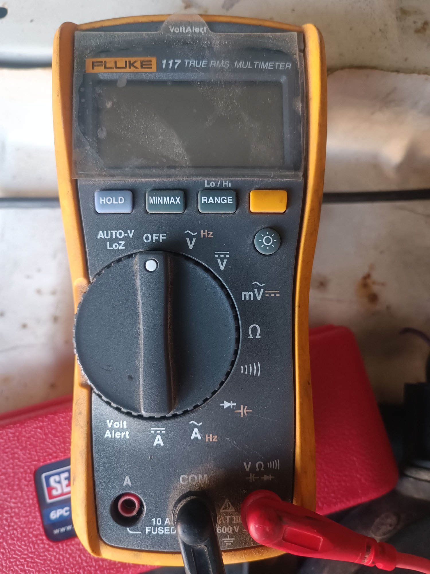

Do you have a vom with hz setting ?
Old May 27, 2023 | 11:55 AM
demelle155's Avatar
Joined: Sep 2017
Posts: 46
Re: another no injector pulse problem
Do you mean this? It has hz but i never used it
