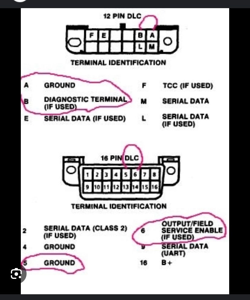

Something is up with your electrical system or ECM it seems to me, I don’t think the fan should come on unless temp is high enough, AC on, or you are in diagnostic mode (a paper clip in the 2 ports for the ECM or scan tool).
Here is a quick thing to try, make a paper clip into a U shape and place each end it in the final 2 on the top right. Once the clip ends are inserted turn the key to on position. The check engine light will flash 12, as in one flash, pause then 2 flashes three times to let you know ECM is functioning and connected. Any codes stored will show after 12.
Use the top picture for reference.
