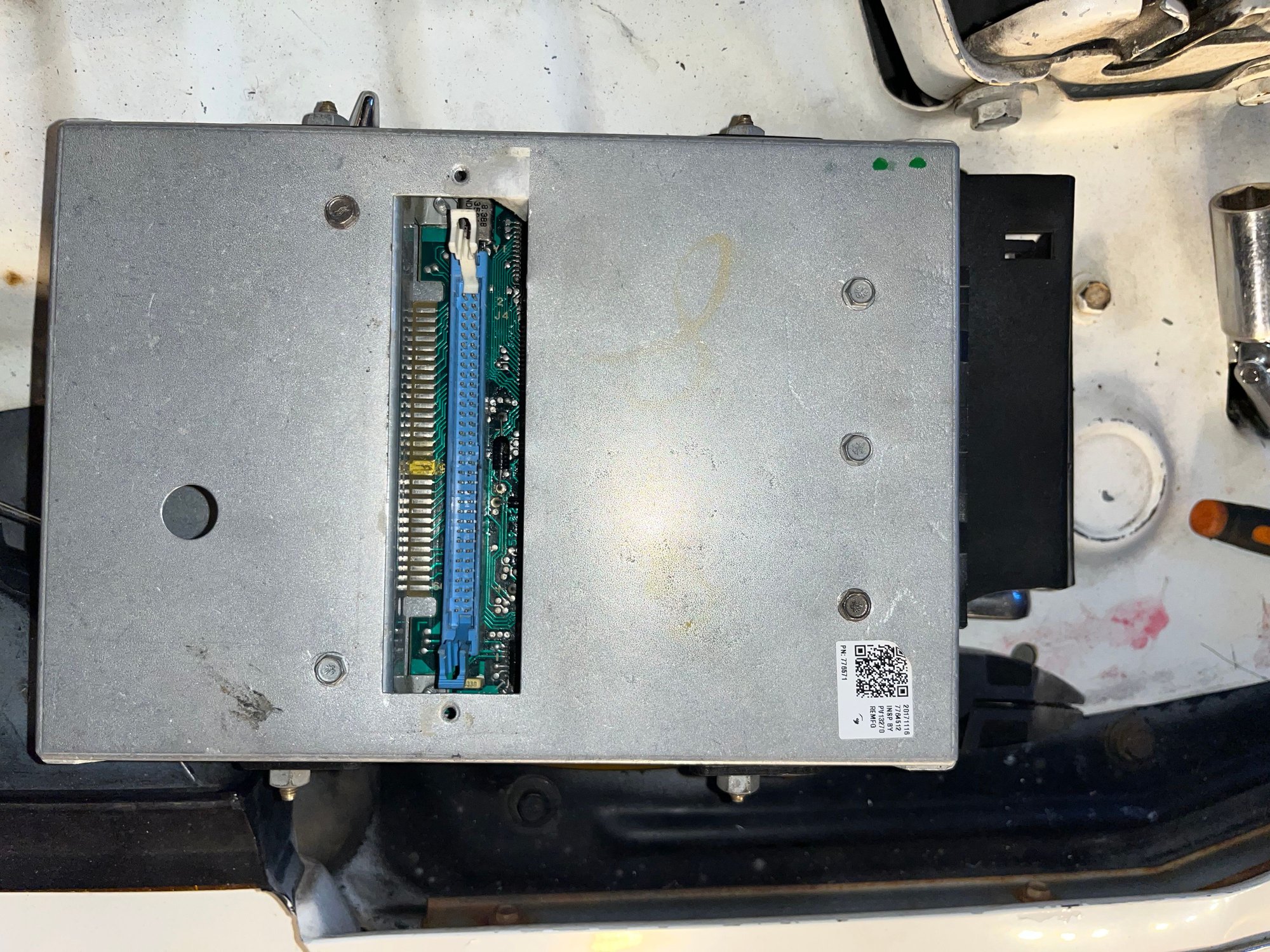

I’ve been chasing ghosts with my 1988 GTA with 305 Tpi trying to get it to idle properly and I noticed that on my scanner the PROM ID says “2491”. I’ve done lots of research and I can’t find a prom chip with the id 2491 anywhere. It’s a 5 speed with the bw 3.45 rear. Wondering if I have the wrong chip perhaps. I know I have a Cardone Ecu that was replaced in 2005 by the previous owner but I haven’t checked out the prom. Any ideas are very appreciated

Look at the memcals BCC and please list.
Information I’ve found is that’s a scan id of a 1227747 tbi ecm or 727 3.1 automatic . I’m thinking it’s a AKHK 88 305 manual 2476 prom id

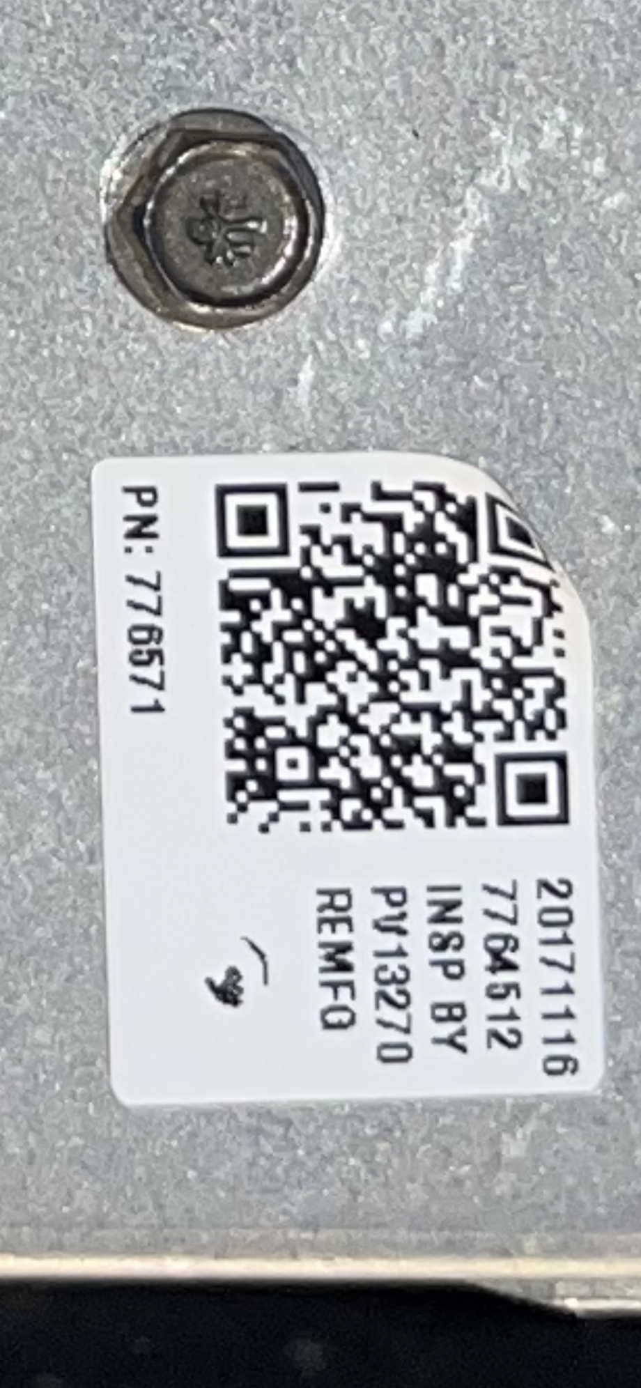

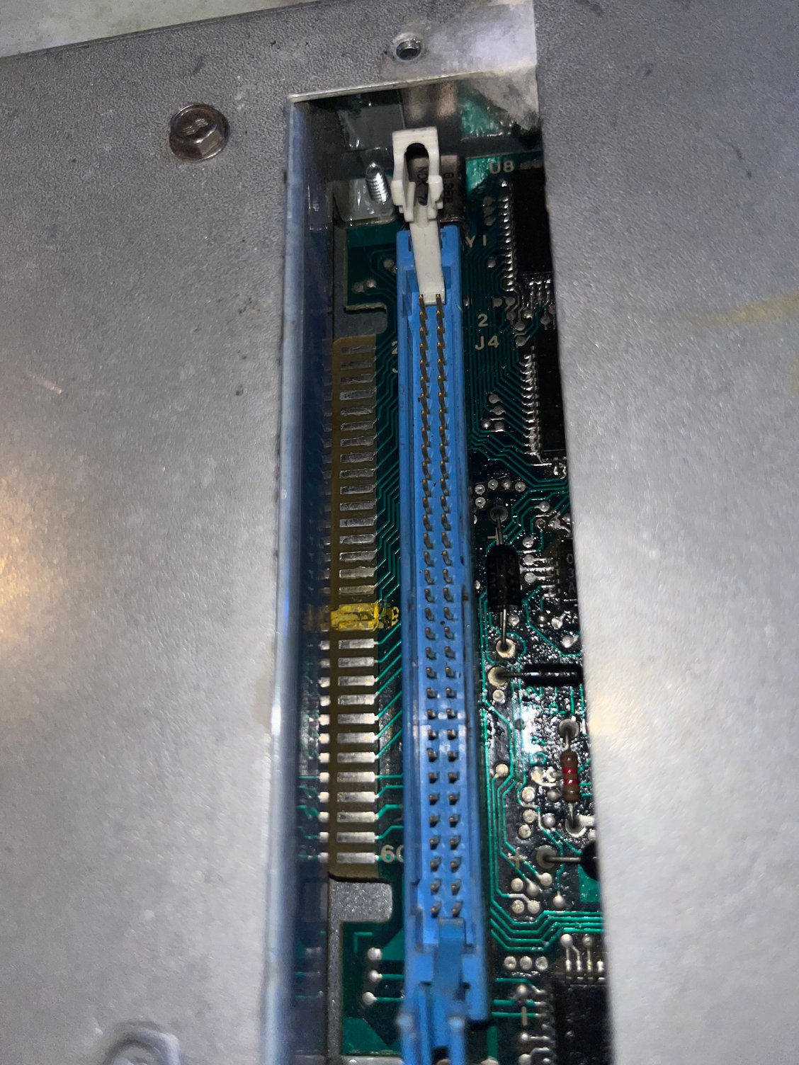

Here is what I found. Sorry I’m new to PROMs and memcals. What’s a BCC? But yes it has the AKHK 2476. I also found what looks to be a rusted contact on the motherboard in the last picture. I should clean it right?

The bbc or broadcast code is ANHK prom id 2476 scan id in the binary file is 2491. I dont see any tsb regarding this tune as having any issues. It doesn’t appear to be listed in the snap on prom id book but i have a program that does id off bcc.
im not seeing the rust or corrosion. Is it on the memcal header ?

This ?

Yes. Could that be not making good contact with whatever’s on it? Or do they not make contact with anything lol

I’m not sure but @rbob may know. I think that’s for board testing and not used once it’s in the ecm case .
