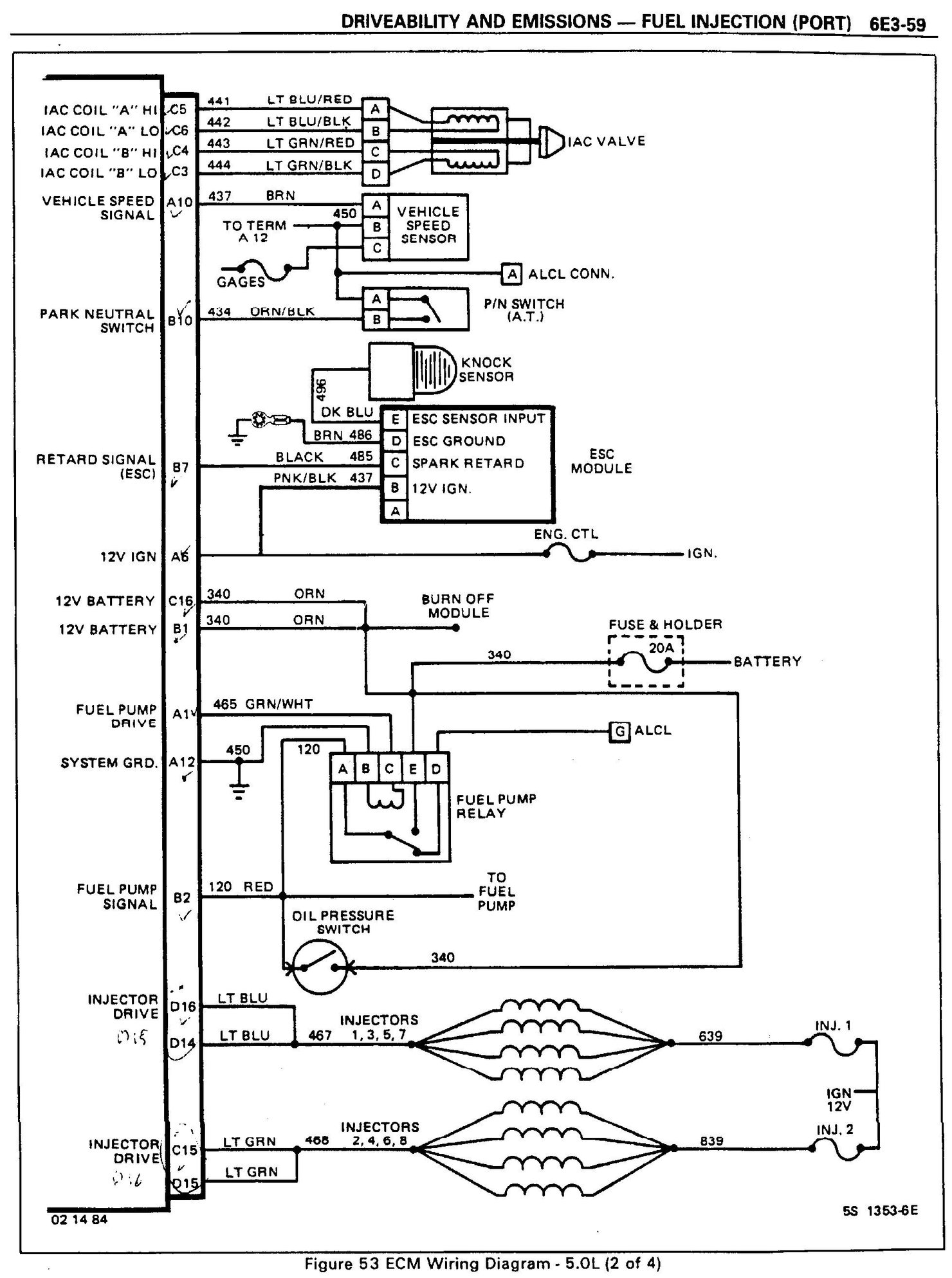

Is it possible to put 12 volts directly to the sending unit to check if the pump is still alive?

Yes, the pump can be powered directly from a 12V source. An easy place to do that is on the red wire at the pump relay, or at the ALDL "G" terminal. The wire at the relay is more direct, taking the relay contacts out of the question.
Bear in mind that some of the older roller and turbine pumps can be fairly quiet, and may be difficult to hear with any background noise. A pressure gauge would be pretty positive.

My fuel pump relay has 5 Pins:
A brown /white
B black/white
C green/white
D red OR orange
E red OR orange (larger Diameter)
The colors of D and E are almost identical. With E having the larger Diameter i assume its the main 12V line.
​​​​​​​So i use D to put power to the pump?

Re: 1985 Camaro Z28 305 TPI Fuel Pump issue.
This is what I have for an '85 TPI:

I checked it at the Relay and again tried to power it up at the sending unit connector above the differential.
Pump is most likely dead.
Im going to replace it the hard way.
