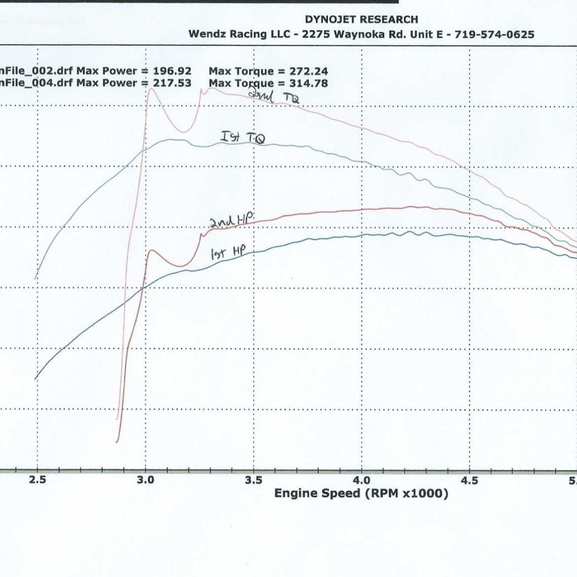

Old Nov 24, 2024 | 01:24 PM
Tuned Performance's Avatar
Community Influencer
iTrader: (94)
Posts: 16,737
Likes: 994
From: Mile High Country !!!
Car: 1967 Camaro, 91 z28
Engine: Lb9
Transmission: M20
Re: New to tpi platform and need a cam
A zz4 before and after tuning at 5280 elevation.

That's^ a 350??
That's^ a 350??
yes a zz4 is a 350 cid
Old Nov 29, 2024 | 06:58 PM
Tom 400 CFI's Avatar
Joined: Oct 2000
Posts: 3,163
Likes: 778
From: Park City, UT
Engine: LT1, L400
Transmission: ZF6, T5
Axle/Gears: 3.45, 3.31
I know. Those numbers seem pretty low, unless they're uncorrected. IDK why someone would do uncorrected pulls though. Or pulls in 1st and 2nd gear.
Old Nov 29, 2024 | 07:03 PM
iTrader: (94)
Posts: 16,737
Likes: 994
Engine: Lb9
Transmission: M20
What’s your elevation and dyno numbers for your L98 ?
4500' or so.
I would have expected close to the same hp and tq at that elevation. Just a comparison of how tuning affected this engine. I’m expecting to loose up to 50hp on a 412 build I just had put together and dynod at close to sea level.
412*.85=350.2...so a little more than 50, even.
But your other engine, that ZZ4, that'd gain ~3% coming to SLC from Denver, so 217*1.03=223hp. Or so.
Elevation is rough for us.
