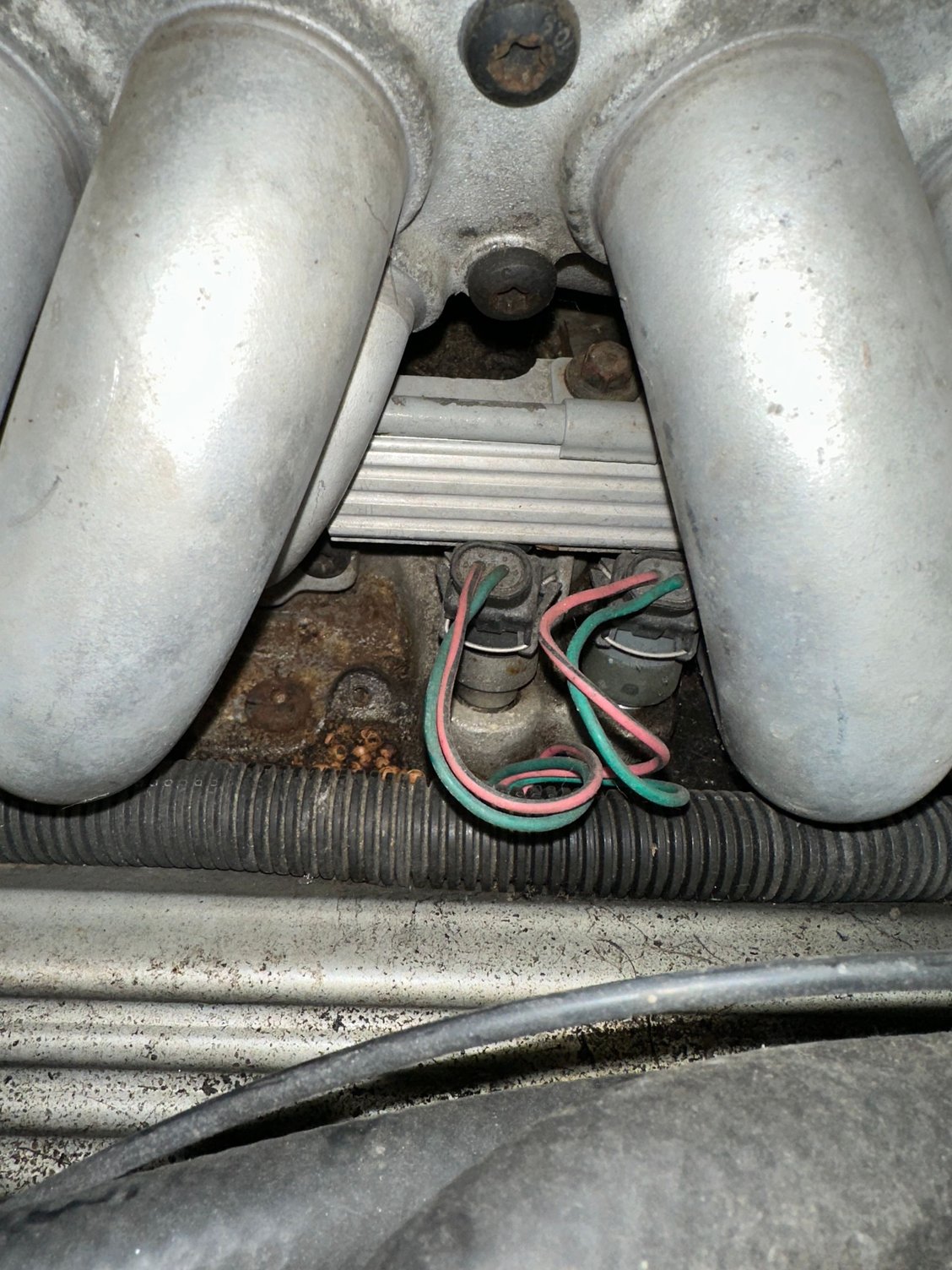

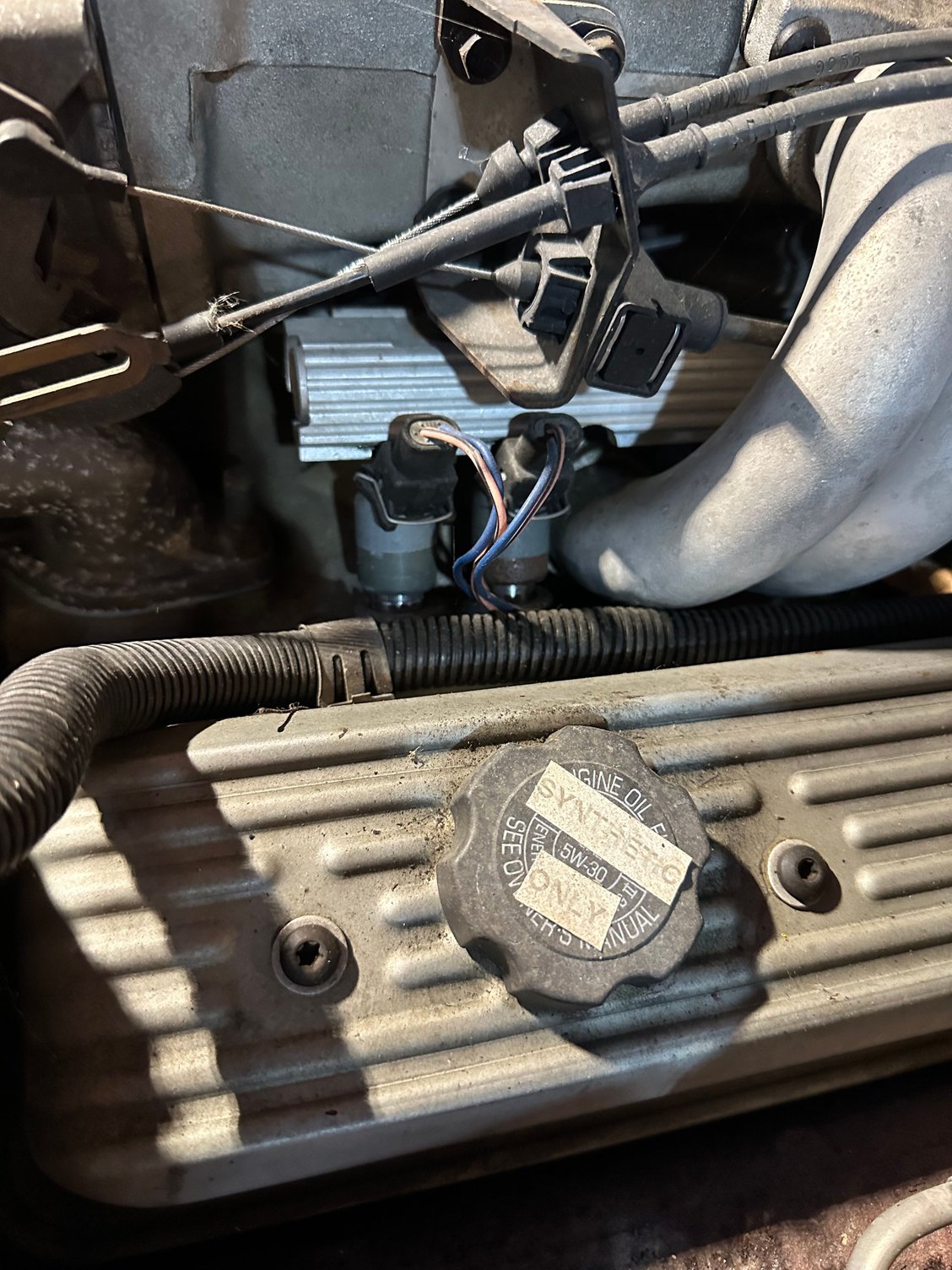

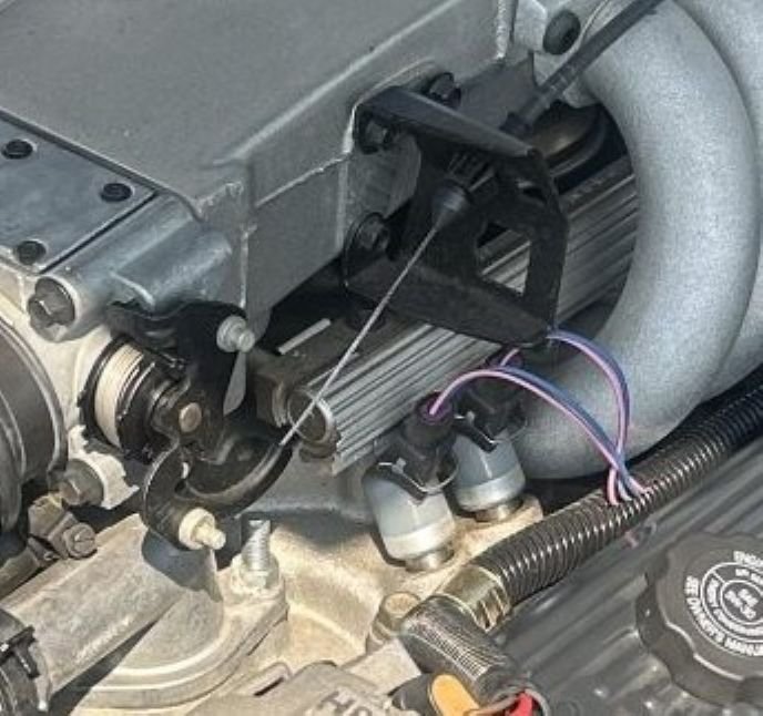

Take a picture of the engine in your Dad's IROC-Z that replicates the picture below so we can see which fuel injectors are installed in the engine now. Look over the engine and verify that all 8 fuel injectors are the same as the two you took a picture of for us. If any of them are different then take a picture of them too. They liked to get cute back in the day and only replace the RP Multec fuel injectors that tested bad instead of all 8 of them. They are all bad even if they test good. All 8 RP Multec fuel injectors are bad and go straight into the trash without testing. RP Multec fuel injectors that test "Good" are little hand grenades with the pin pulled so far out it's hanging on for dear life and the least little thing to disturb it and it falls out and RP Multec goes BOOM!!!
The insulation that Rochester Products used to coat the wire of the "voice coil" that drives the pintle up and down inside the injector can't stand up to alcohol, harsh solvents, HEET, gas treatments, fuel injector cleaner that wasn't approved by GM for use with RP Multec fuel injectors. Pretty much they can't stand up to anything that wasn't real pure gasoline back in the mid 1980's.
Multiple things can be wrong with the car at the same time for a car this old that has sat for so long. If the engine still has the defective RP Multec fuel injectors installed then trying to address any other issues it has before replacing the fuel injectors with the proper brand new Delphi fuel injectors designed to be a 100% drop in replacement for the RP Multec fuel injectors is the same thing as pissing into the wind.
1989 to 1992 RP Multec Fuel Injectors. Retroactively Defective by Design.

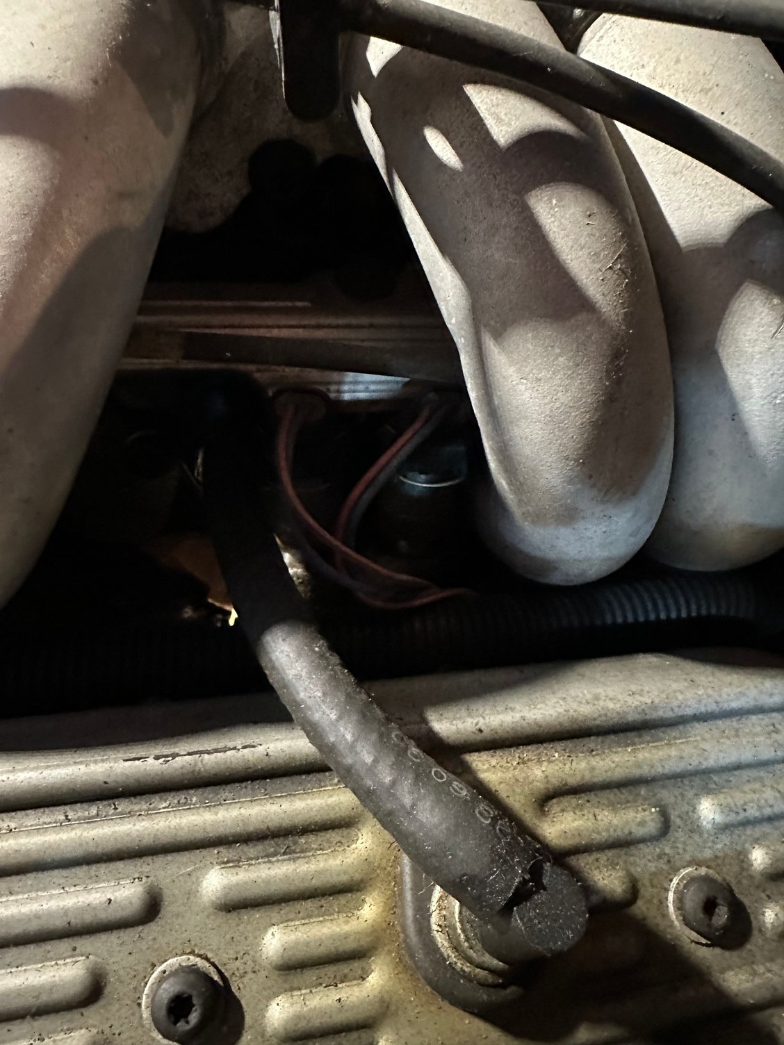

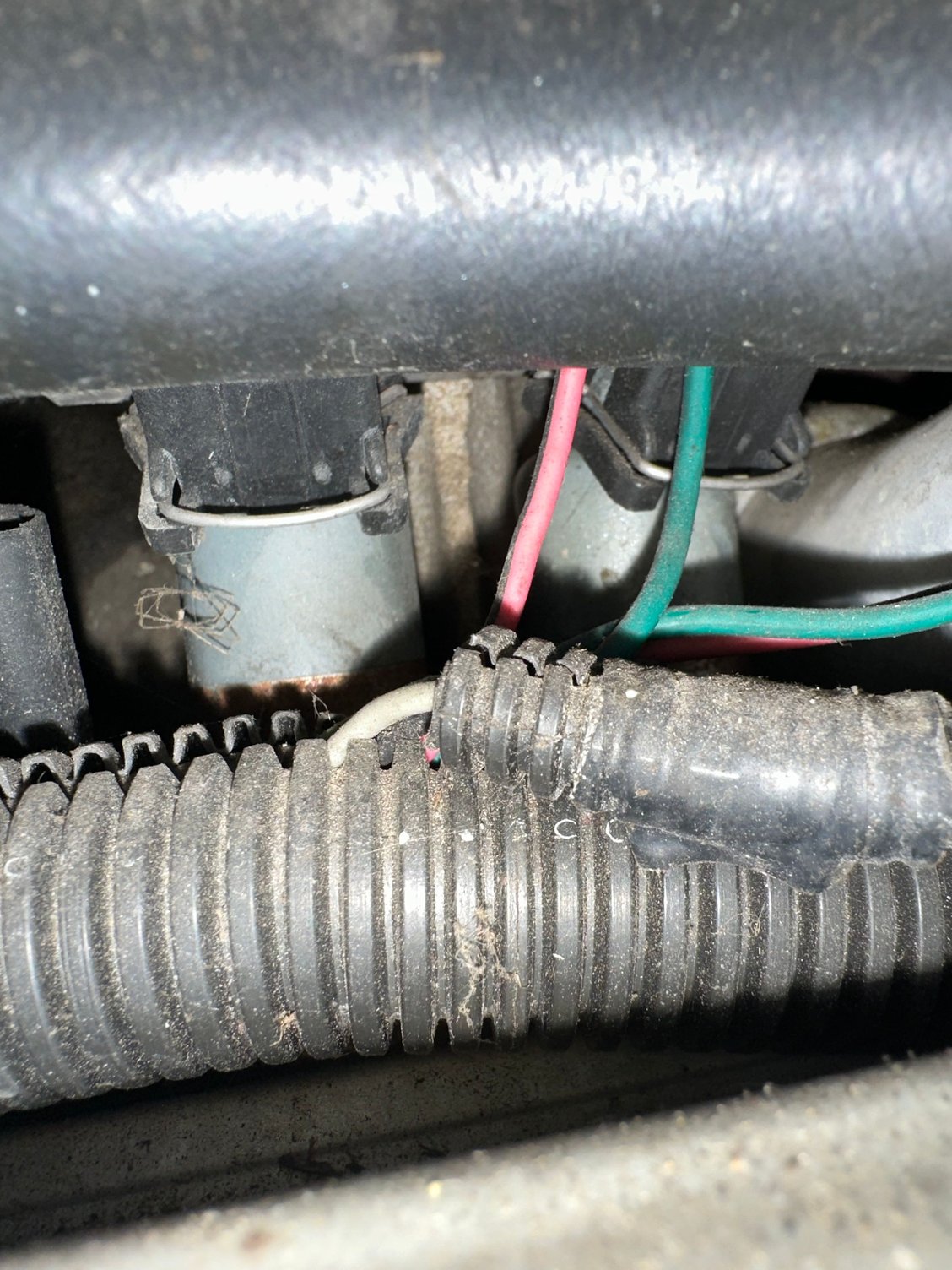

Here you go sir
Here you go sir

Well you have a mixture of the bad RP Multec injectors and some newer old replacement injectors. Straight to the garbage they all go.
I can put together a list with links of what you will need to fix this part of the engine not running right puzzle if you would like.
