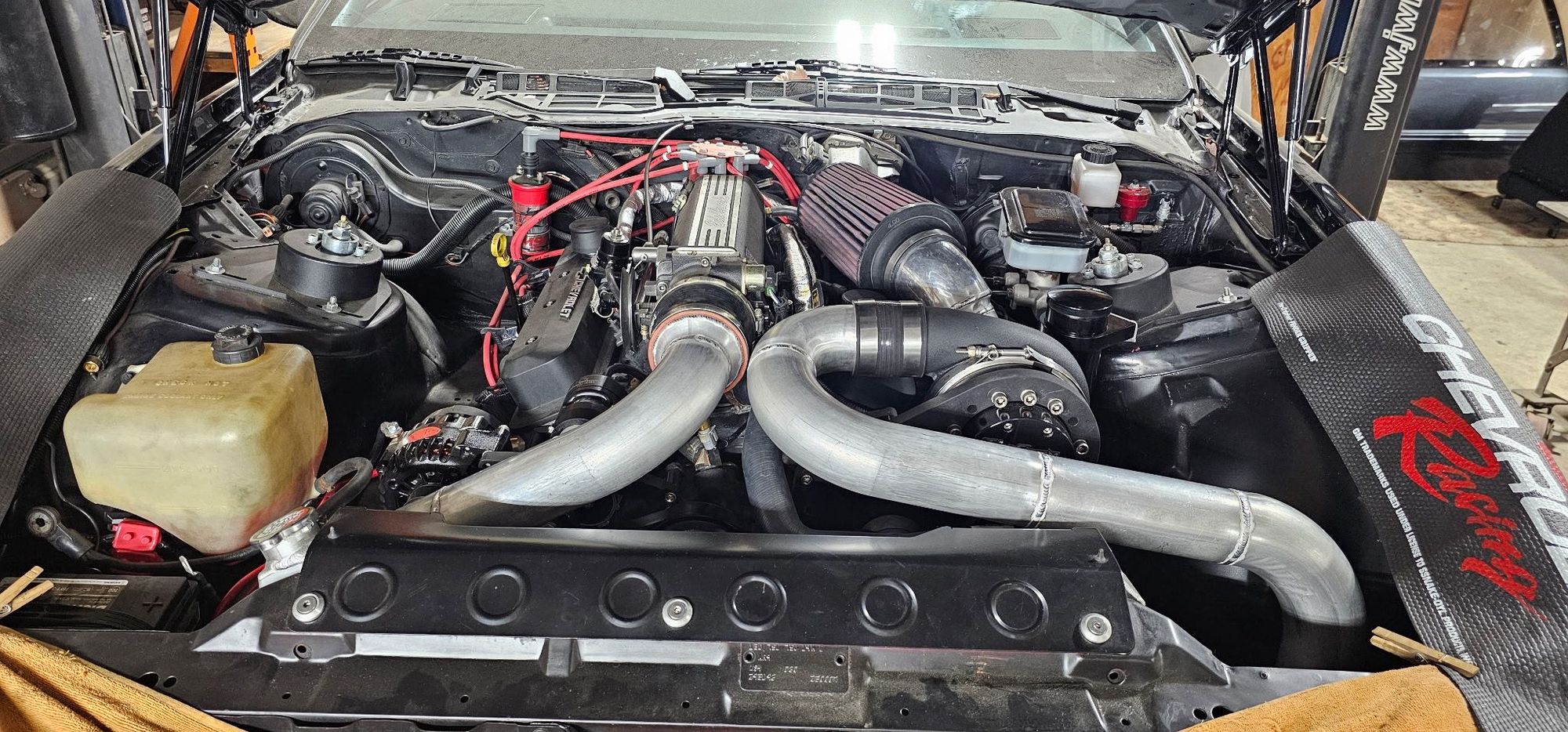

It's a cast intake isn't it? Also, that air system layout is insane!

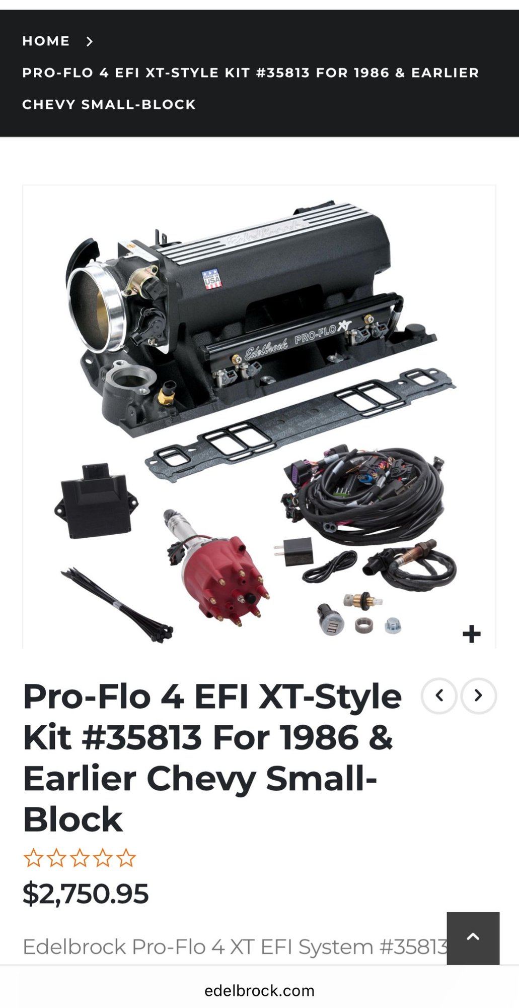

Yeah, it's cast. It makes great power up to 6k (I haven't had it past there intentionally). The first pic is the my setup prior to the blower. It was great that way. I had it like that for 4 years. The pro Flo systems are pretty easy to get running well. The xt intake works really well in 3rd gen's
i just noticed the price! I think I paid 1900 in 2019 for mine!
