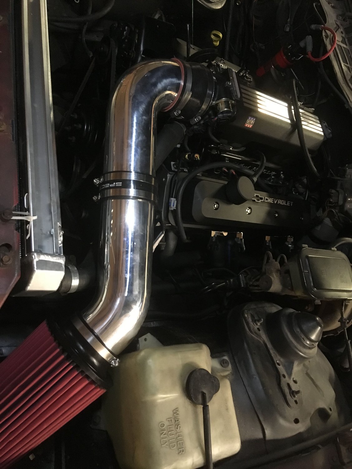

Other than finding an extremely expensive used SLP intake box, what are people doing to improve the 90-92 firebird induction. I have a K&N filter in the stock induction, but i feel like that doesn't really do anything. I have Dyno Don Headers and dual cat ypipe waiting to be installed as well as Magnaflow cat back. Again, not looking for the highest numbers just a strong street car.
you could just build something like this. It was super easy.

Lingenfelter intake
58 mm tb (came with the car when I bought it, otherwise i'd pick 52 or keep the stock tb)
Dyno don headers
185cc 2.02/1.6 heads, 1.6 rr's
Fitech TPI
Stock converter and 3:23
except I chose the 8801 cam. My induction system supports more than I will ever need. My plan was build it for strong midrange (2.5 - 4 k rpm)

I more or less got what you got:
Lingenfelter intake
Dyno don headers
Fitech TPI

So why did I go with that cam? Well, the original plan was to optimize the shortblock, to let the stock bottom end (including the stock cam) breath as much as possible but while I was in there doing the heads I thought "might as well...". The 8800 is like 5% bigger than the original 773.And, in reality I rarely have the car above 4500 rpm. It's the occasional on-ramp or straight country road that sees WOT, everything else is more or less city driving.
I like the character of the car. Very torquey.
I will dyno it next year.
