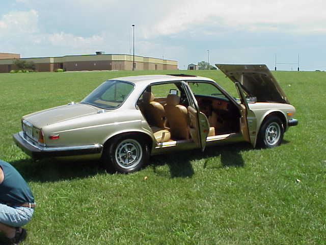

I am running mine in a Jaguar sedan that weighs just under
5,000lbs, yes that's 2 and 1/4 tons of iron, leather and oak.
My best time is 13.89 @ 96 mph with 2.88 gears.

high rate of speed. He saw me comming and would not let me
pass until we hit a 1 mile straight section then I got around him.
He stayed with me right on my *** at about 80mph until the road
straightened out heading into the country. He tried to pass me
but gave up at about 140mph and I just kept pulling away from
him. The Jag speedo goes to 140 and it was burried and the car
was still pulling pretty good. After about 10 miles we came to a
stop sign on a highway and I went one way and he gave me a
honk and a wave as he went the other way. I felt pretty good
on my 30 mile trip back home to where this encounter began.
The time and speed are the best of 5 runs on a good road
using a G-Tech, I don't know how accurate the G-Tech is
but that's what I am going by. I have not had it to a strip to
get a real time on it yet, the strip is a long ways away.
The motor started as a 96 Chevy PU 350 Vortec. I pulled the
heads (I know, I know) and cleaned up the ports on a set of
94 Chevy PU 350 high swirl heads, the intake runners have
a swirl action to them and are designed promote more even
and complete combustion. I did not have them flowed but
looking through the intake port the valve guide is floating out
in the middle of the roof with a ramp that swirls around the
back side of the giude to set the air in motion. The guy that did
the valve job said the local dirt track guys use them for midrange
power. It is also setup with 1.6 rockers on the Vortec cam and
the stock intake which has been ported for all it's worth and a
reworked throttle body with airfoil. Yellow top injectors and an
AFPR set at 52lbs and an 88 Vette prom. Ported ramhorn
manifolds with no catalytic converters and 2 1/2 Mandrel bent
duals out the back.
duals out the back.

Another shot. I like to think of it as a 4dr Corvette with all the
Brittish electrical bull****. It launches hard, REAL HARD. It don't
get much tire spin at all when all the weight transfers to the rear.
Just bites the ground hard and pulls hard. Sooner than later I
just know something under the rear of it is going to break and
it ain't going to be cheap.
