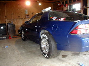

Old post..as you can see from my sig Ive done a bit of modding lately and it all works quite well at 500 hp NA ....Nope , I dont have a dyno sheet but the builder ,RHS, gauranteed 525hp.
I finally have it all together now but I cant give you any time slips till after I have this back surgery.

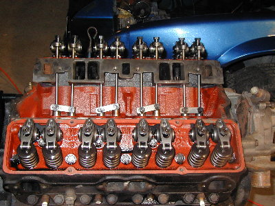

one more
