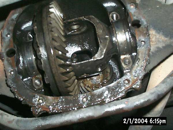

Heres what I got off, I can't figure out what is holding it in.
Attached Thumbnails How in the hell do I remove the old unit in the differential?-diff.jpg

somtimes a litte careful pring is in order!!! should come right out

Use a heal bar or a small crow bar. A little force and it pops out. Just make sure to note which shims were on which side and which way they were facing.
Edit: even a nice sized screw driver behind one of those ring gear bolts on the drivers side will pop it out easy.

pry on it a little, nothing is holding it in. it should pretty much fall right out.
