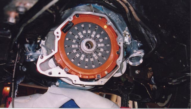

Here's another vote for Centerforce. I'm running a Dual Friction with my T-56 and like it quite well. I had a RAM in my '69 GTO and was not impressed. I put a Dual Friction in and it held much better, although I found out that the main issue with clutches was my rear main oil leak
Anyway, I don't think you'll be disappointed with the Centerforce, it's a very strong and streetable clutch!
