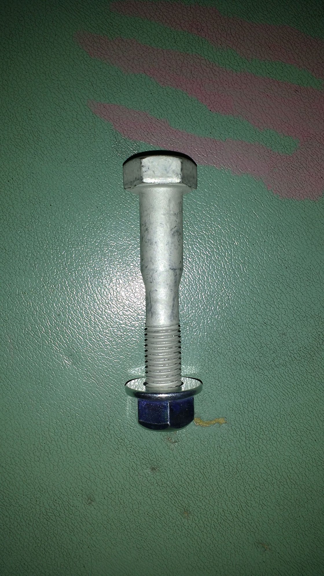

I couldn't find the bolt through GM. I ordered mine from hawksthidgen.com.<br/><br/>http://www.hawksthirdgenparts.com/panhard-bar-mounting-hardware-kit/<br/><br/>$11 for 2 bolts & 2 Nuts $11 shipping.

I found the information helpful. It was a current problem for me. I lost my bolts. I didn't fully understand what the stepped bolt looked like. This was one of the three threads I found so I thought I'd contribute for next guy, who might search for it the same way I did. Google.
