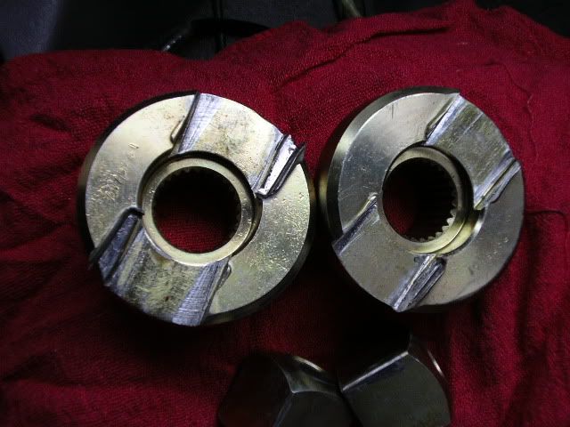

Put this in my friend's 82 z28. After we noticed a loud bang at every corner and severe wheelhop, we checked the axle shaft end play. They were moving about 1/8th of an inch side to side!
Called richmond, they said we needed thrust washers to make up for the size difference from the factory diff to the mini-spool. Took it apart, here's what we found....
Thank god for a warranty.

Why would you run a mini-spool on anything that's gonna be street driven? If Richmond hears this you'll be out-of-warranty.

incase you didnt know both wheels are locked together and make turning difficult especially on the street. thats why it broke

I agree with Shagwell, you CANNOT run this on the street, it will break. You need a limited slip diff. On a corner the inside wheel must turn at a different speed than the outer wheel, if the differential is locked as with a spool, one tire must slip on the pavement, well if traction is good enough and the tire doesn't slip, you break parts.

a mini spool isn't built to be run at the dragstrip either. they are made for dirt tracks where traction would be limited always. you're going to end up breaking this again.

Try finding a full spool for the GM 7.5"... Not easy.
And how would that happen again? You obviously dont know how it fits together. If the thrust washers take up the play, the square center pieces wont be able to jump around like that.
