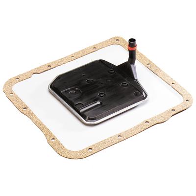

There's no way a transmission filter could just be thrown in the pan upside down. This is a 700R4 filter:

the way the filter is shaped, you can't get the pan on if the filter is upside down. the neck is to long.
