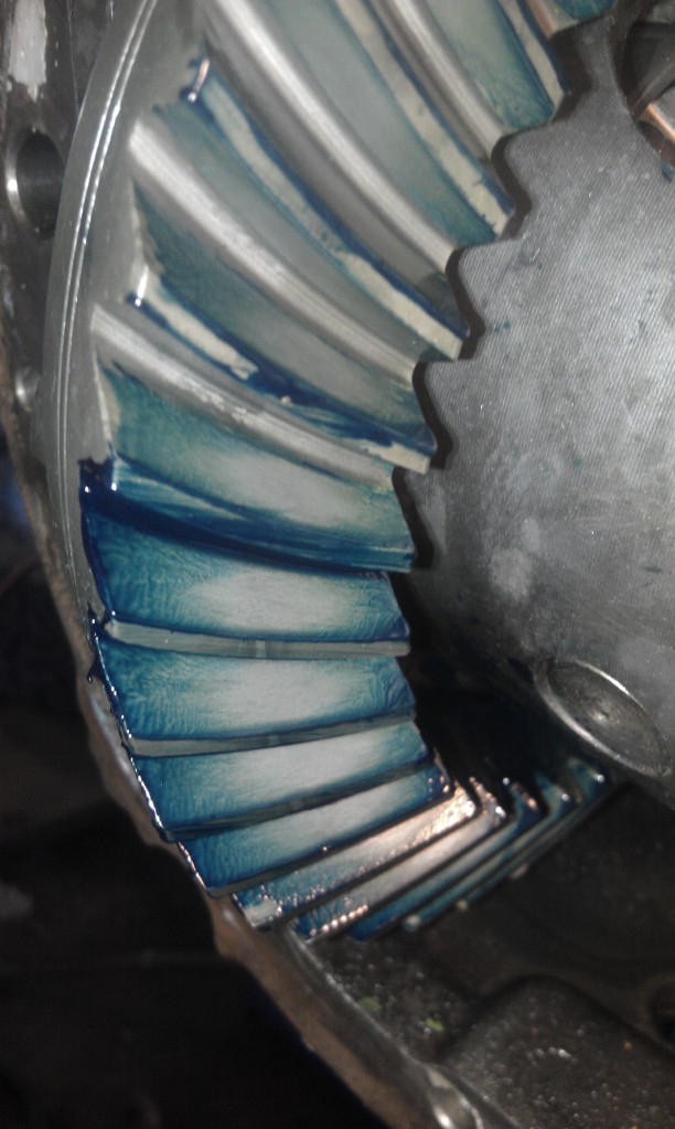

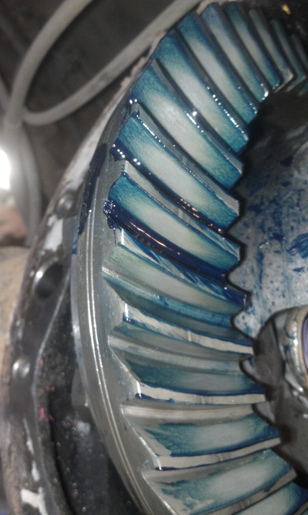

This is the first rear I've done, read more books and looked at more pictures than I can remember, and I've heard and read all the step by steps of other people in thier rear assembly, but I just want to do this right the first time. I set up the rear so far to the best of my abilities, checking some things and pattern being one of them, here is the pattern I'm running, and I think it's pretty spot on...I haven't set up ring back lash yet, or pinion preload, so it's not nearly done, but this is what i'm coming up with so far :
Drive side :
Coast Side :
and some zoomed out pics :
Drive : http://i283.photobucket.com/albums/k...7/IMAG0417.jpg
Coast : http://i283.photobucket.com/albums/k...7/IMAG0418.jpg
Let me know what you think. Like I said, I still need to get back lash and pinion pre-load set up, but before I tear it apart getting it ready to go back, wanted to make sure I'm going in the right direction with pinion depth and relative carrier shimming. Just looking for some quiet long life gears.

Looks great ! Driver side is a tad high and coast is a bit low but I'd run that with no worries.

That's what I was thinking, but my concern is that I did a new ring and pinion, new auburn LSD, new bearings and all, and used all the original shims for pinion and carrier and this is the result I got, just concerned this was a little too easy and I was missing something before I started pressing pinion bearings . Again I need to set it up for backlash, I think its rather tight, I haven't measured it yet, but from what results I am getting I wanted to make sure I was interpreting the pinion depth correctly.
As far as changing that high/low situation, would a hair larger pinion shim center things more?

Alright, finally got the chance to tinker with this setup, and here is my results. I tried to go a smidge more on the pinion shim, and it went all out of wack (low flank on drive/coast). Went a hair smaller on the pinion shim than the results above, and with the same shims holding the carrier left to right, and this is my results :
Drive :
Coast :
This is with the axle slid in, so it's loaded markings. I need to send the carrier a smidge to the right, as i'm about .01 off the top spec of backlash, but let me know if this is what I'm supposed to be looking for in a pattern, and I can go ahead and start pulling it all apart (after getting proper backlash obviously) to start pressing the pinion bearings and set up pre-load there.

JMO. i get lucky 90 percent of the time re-useing the stock shims. im no expert, and its a lil hard to tell by a pic, but id run it. my only opinion from your last pics is that the pinion depth might look a little shallow? looks like a nice even wear pattern though.

I thought it was a tiny bit shallow, but this seemed to be the best that I got it, plus I won't be beating on this vehicle at all, automatic so i wait till it's in gear, I take off smoothly, and possibly accelerate aggressively from there if I needed to, otherwise I won't be beating it, and with that much contact patch, kinda figured it should be a nice smooth and quiet setup.
