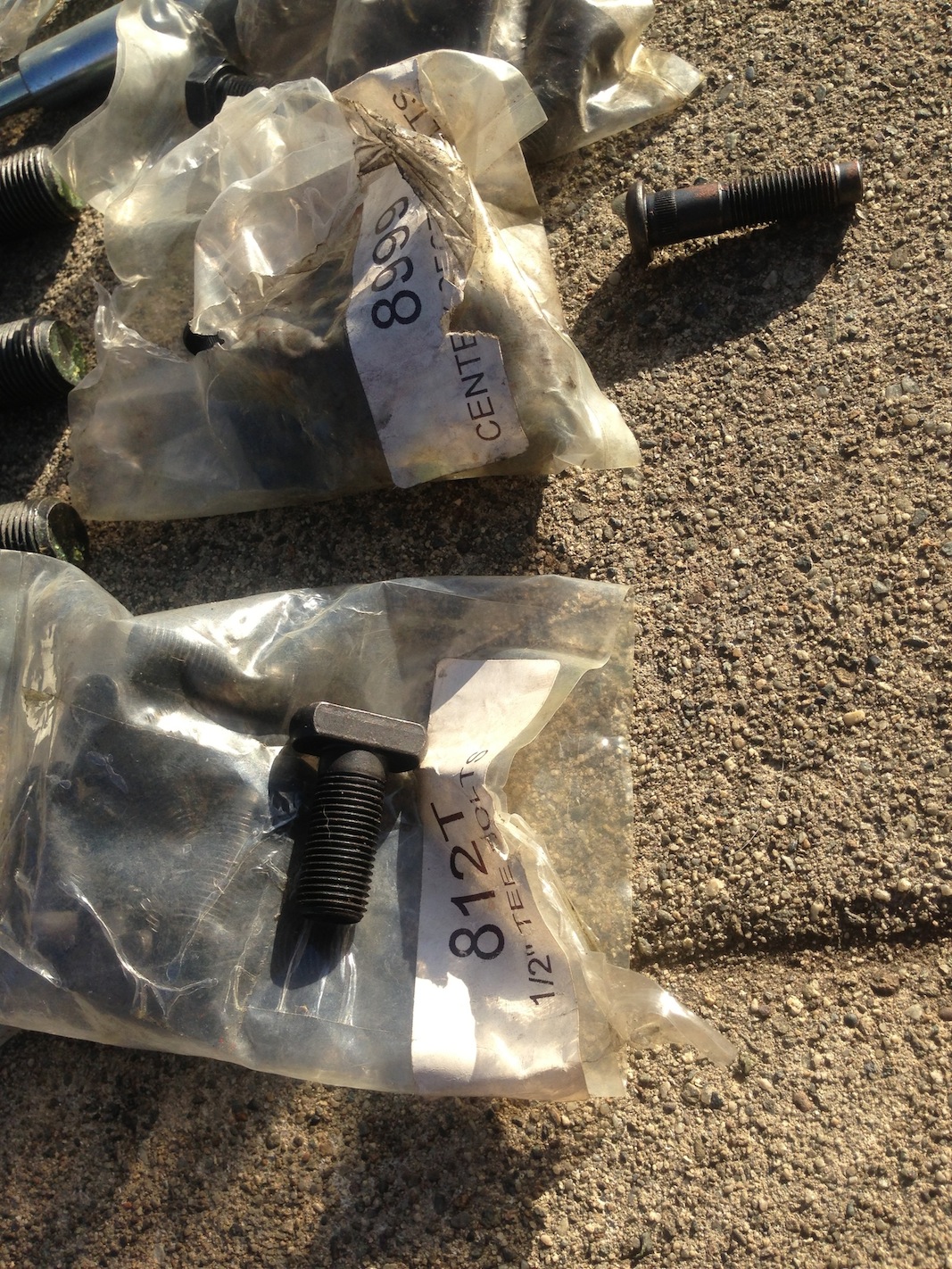

Thanks for the ton of info Big Gear Head, I will post pictures After work this evening of my Rear end, its the Housing that appears to be welded (Pardon my lack of term knowledge) but im not as educated in this field of drive train enough to 100% validate it is in fact a welded diff (i mean i dont even have a differential)..
Im comparing it to the pictures of how they ship out the rear end and it looks no different, Gutless from where the driveshaft- center section - yoke - diff go in place, but on the rear where the axle cover usually goes it seems welded on ? either way its definetly not coming off and before i dig this up any more or call it a loss ill add pictures asap.
You are correct the package did NOT come with Axles or a locker/differential i also questioned the seller this and he didn't know anything about a motor vehicle other than the gas and brake pedal and what they do.
This is why i got the package for 400$,
The Brakes are the PBR Kit 13" Rotors in rear 2 piston caliber, No different from the El dorado calipers. also included proportioning valve, stainless steal lines, the brackets and back plates to install as well.
I've seen a couple lockers im interested in like the Eaton Elocker which would be fun to have on board control of open rear and limited slip but this is more of a 'for fun' idea rather then 'practical/ideal'.
For the Price of that locker (800$) i compared it to this set
http://www.moserengineering.com/spoo...35-spline.html
Which i can order in a 31 spline axle set, and 31 spline wavetrac diff unti, if i went with this would i need in specificy the setup kit that comes with a 31 spline pinion and yoke 3.062" OD, and pinion support 3.062" OD Or am i missing anything else? Am i even close
Is Daytona a reputable manufacturer of these parts or do you have a suggested manufacturer i could look into for the support ?
Are the wavetrac unit lockers even in the same ball park as Auburn, Eaton, and Detroit ?
I was personally looking at Detroit TruTrac differentials but don't know if the wavetrac is a viable substitute?..
Don't want something thats going to preemptively fail after xxx amount of use and dont want to have it be the diff especially that ***** on me, anyone with experience or knowledge please chime in on this!
Where i stand now is confirming if the axle housing is applicable(welded on or if its not), and if it isn't welded, what axle/spool/pinion/yoke/support to get into and how to match them so i know they'll all work together including with my stock 91 rs Drive shaft (should this be upgraded as well..?),
is it just all 31 spline, 3.062" OD, parts i need? don't know what the mated setup kit is if i were to get a 31 spline axle set, and im sure as hell not spending the 1500$ on mosers ultimate http://www.moserengineering.com/asse...ac-9-ford.html
Is everything in that kit what i need though?
If so where can i find some mated setup kits with pinion and supports?
So many questions i apologize.. i know no one probably wants to read this crap after a long day of work/wrenching/play
but it means the world to me even for just a response with a few carefully compiled sentences.Typed enough here, ill Get the pictures up when i get home.
Thanks for the response
P.S. Are these the Seals you were talking about Big Gear ?

Here are the pictures of what i can't identify
in the first picture if anyone can tell what the thick heavy iron cast looking part next to the tunnel trans mount is and what its for that would be great, i've been
on that one.The second picture i have no idea what is or what for..
If anyone can identify which transmission the mount is for too that would help, but i understand this may be impossible to confirm over a small picture and text characters, if there are any cereal numbers or measurements i can take of it let me know if possible, i would like to get the one for my t-5 B&W if it just magically happens to be that mount i guess i lucked out but wont know until i know how to decipher which transmission its for.
Also appreciate the

Re: Moser Ford 9" Help
I need to see pictures of the caliper brackets to see if they will work on the old style big bearing Ford ends. Pictures of the calipers don't help.
The part in the second picture is a fixture for holding the 9 inch Ford case while you assemlbe it. It is made to bolt to the top of a work bench and then the case bolts to the arm. It's a very nice tool to have. It allows you to rotate the case while you assemlbe everything.
on that one.
Also appreciate the
Also appreciate the

Those T bolts in the second picture are 1/2 inch, which is what you need. If you have 8 of them then you are good. The bolts in the middle of the third picture are the bolts that hold the chunk in the housing. There should be 10 of them, along with nuts and washers. The bolts on the right look like the ring gear bolts. The two large nuts are pinion nuts. I don't know why you have two of them. The rest of the bolts must go to the brakes and torque arm.
ill double check when i get back from work.there are 10 Center Section bolts
i had no idea what the 4 bolts on the right were
Is Loc-tite or any solvent/addidtive necessary prior to installing any of these bolts ?
How many Pinion nuts should i have?.. and are they in usable condition ? They just look a little worn.
im going to put all of them in labeled bags when i get home and whatever's left over in hardware ill take a picture of for further clarification.
As for the torque arm mount, is there any distinguishable number or measurement of the mount to see if its the correct one for my transmission ?
sorry for asking twice just not sure if its for my setup and also if anyone can chime in and confirm what this part in the picture may be ?
all of this is vital to the build as i am only 20 years old, and my knowledge falls short of where i could confidently tackle it on myself, Couldn't Show my gratitude enough nor do it without your sharing of knowledge

The part in that picture is the fixture for holding the center chunk for assembly. This is what I was talking about in post number 12.
If there are only 4 of those bolts then they are probably not the ring gear bolts. It's hard to tell what some of that stuff is in the pictures.
If the pinion nuts look used then don't use them again except for trial assemblies. Don't use a new nut for trial assemblies. Save the new nut for the final assembly.

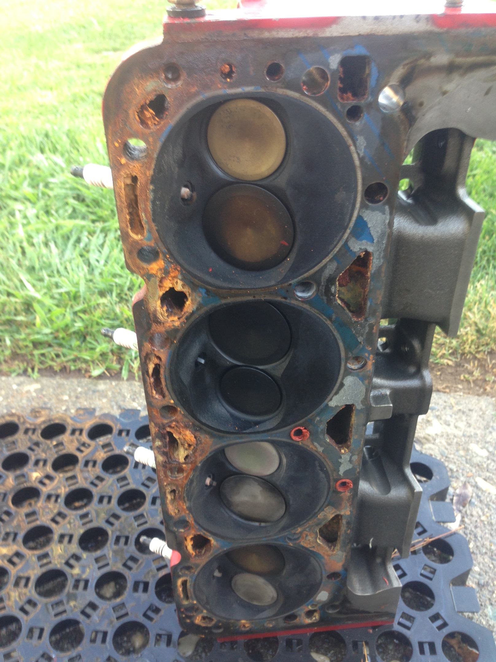

The pictures are a before (1st pic) then After (2nd and 3rd) after i cleaned out the heads with a 1800 psi pressure washer, suggested from the machinist at victory motors rather than have him do the same thing for 60$ in his High pressured hot water virtual washer.
