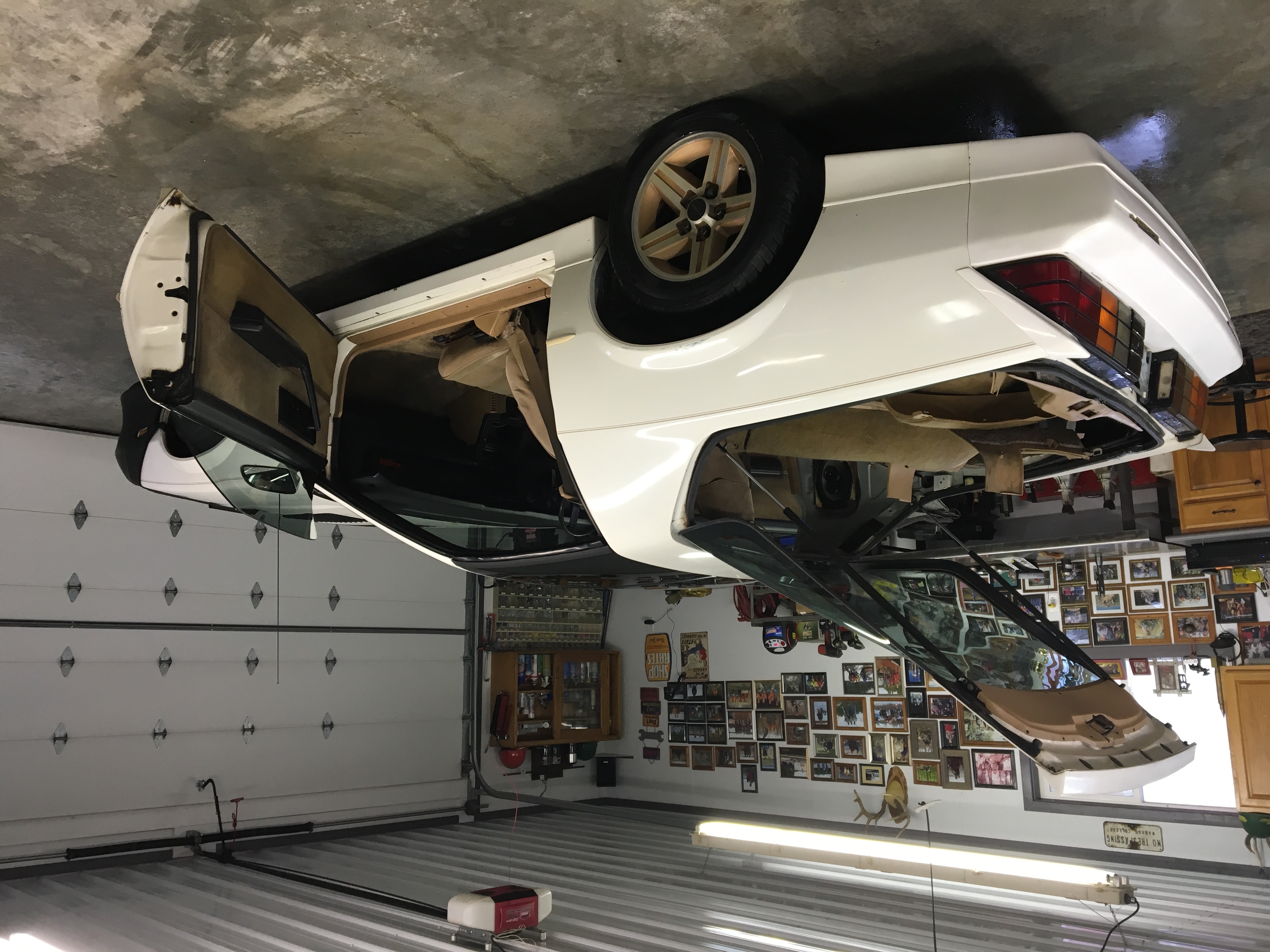

Hey everyone. Brand new to the forum here! I just found a 1986 IROC with the 700r automatic that some older gentleman had in storage for 10 years! I bought it for a cheap price, and here is the story.
The guy got the car in 2004. It ran, but had no overdrive gear. He drove it once in a while, just without overdrive. It sat for long periods of time between drives. The one day, he gets in it, starts it up, and puts it in drive, but it doesn't go. (This is how the story was told to me). After it wouldn't go, he parked it where it sat for 8 years. Then he tried to start it again and it wouldn't start.
So. I drag her home, and found out why it wouldn't start. The guy left fuel in it for 8 years. The fuel went bad, turned to slime, and seized up the fuel pump. The fuel pump was literally stuck solid.
So. I have a new pump and fuel tank coming in this week. And I'm hoping that is all it needs to start up.
Now I was just wondering if, from the little information I have, if anyone has ANY ideas what to start with on the tranny, if it does what he said it did. I know I don't have much info yet. Just tying to get the ball rolling.
Glad to be a Camaro owner finally.
Cheers.

Car looks good, check the fluid, drain/replace & try it. If need be swap it with a spare.
Fixed the upside down pic for ya.
BTW, I have the same Galvalume ceiling going in my barn - do you find it noisy in your garage?
I dont have any issue with noise. We used spray insulation in the attic overhead, so that most likely dampens it a lot. Are you doing it yourself? If so, I suggest getting a laser level. the kind that projects a red line. We used it to get all the screws PERFECTlY in line. The old man is a bit of a perfectionist, but i have to say it looks awesome that all the screws are dead-nuts straight.
