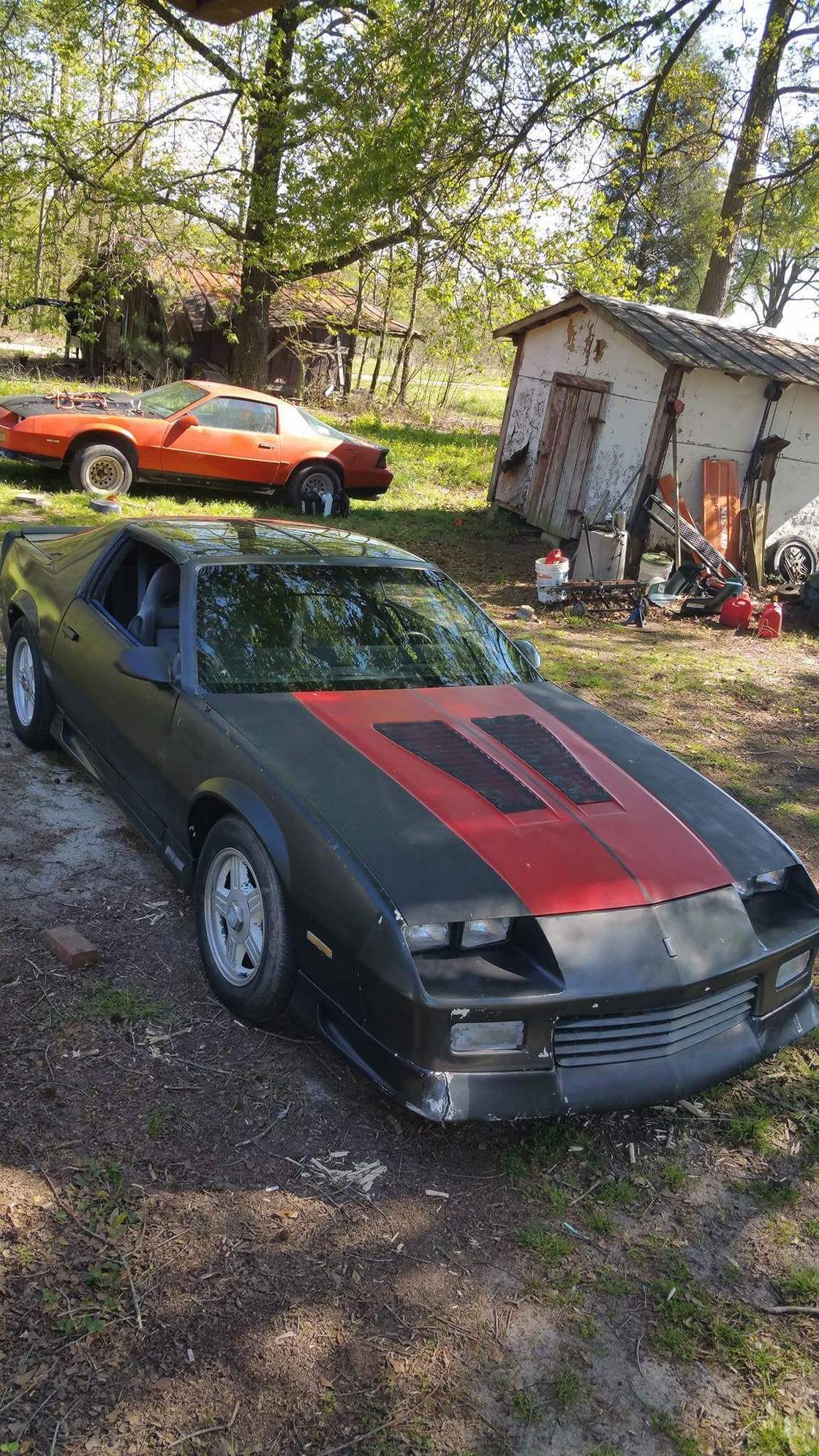

What does yours look like? When was the last time you put one in?

Had the car a few months. Wasn't running when I got it. Running now, and having problems with trans.

Can't see the pilot bushing in that pic?
