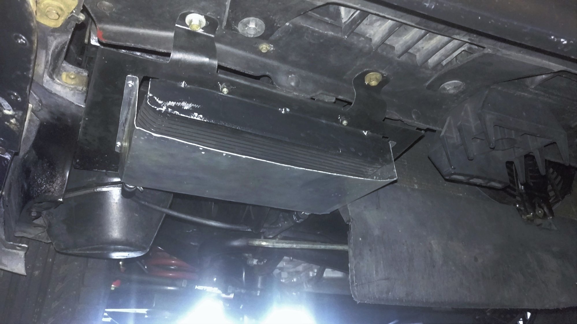

This is where I mounted mine, made a little air scoop to aid cooling.Its the smaller B&M, using the stock cooler too.
Then grafted a pod on the pillar trim,for the gauge.Temp runs about the same as coolant (190-210).

where is the temp sensor? that is still running too hot in my opinion.

Sensor is on the trans case, in the diag/test port.It peaks at that temp & takes a while to get there.I dont think thats too hot though.

That is too hot. It wont dissapate heat there. If your sitting there is no airflow across it. Its best to put it 1/2 inch from ac condensor if you have one or 1/ 2 inch from radiator. If you can get a small spal fan on the back of that you will be ok. I would worst case scenerio be at 180 max under acceleration. Your not even driving. When your convertor is slipping if I assume you have a decent stall thats where all your heat will be. If you decide to move it and have dual fans put it in front of the primary one.

It runs about 160-175 on the fwy & takes forever to get there.That pic was taken after i returned from some "spirited" driving thru local cayons w/ a couple buddies.
I have a small 5" fan from an old R6 that i though would be perfect for this.Just havent bothered making a go at it.Its there cause there is a fan in front of the condensor already that i have no desire to move.

Either way you dont want the temp there after spirited driving. The cooler the better. Under 180. You drove it hard and then you get stuck in traffic just say. There is no air flow across that cooler unless your moving. That why in front of radiator is best spot. Or in your case put a fan on it with a temp probe to switch it on and off.
