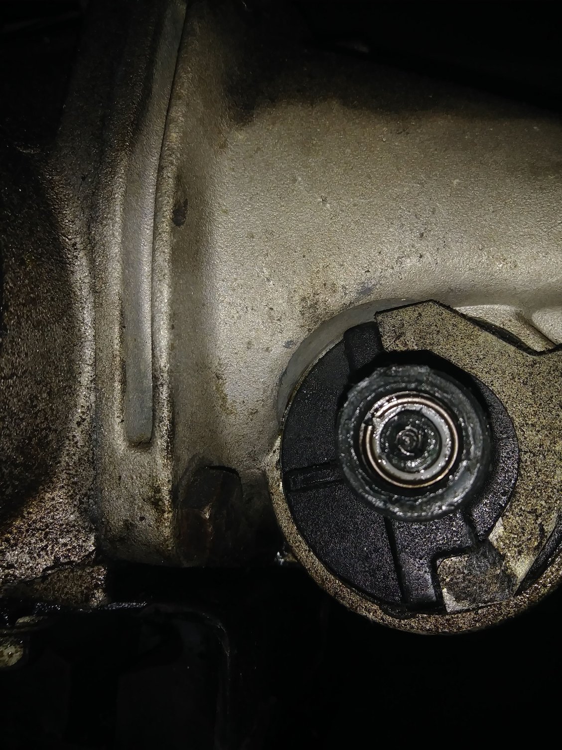

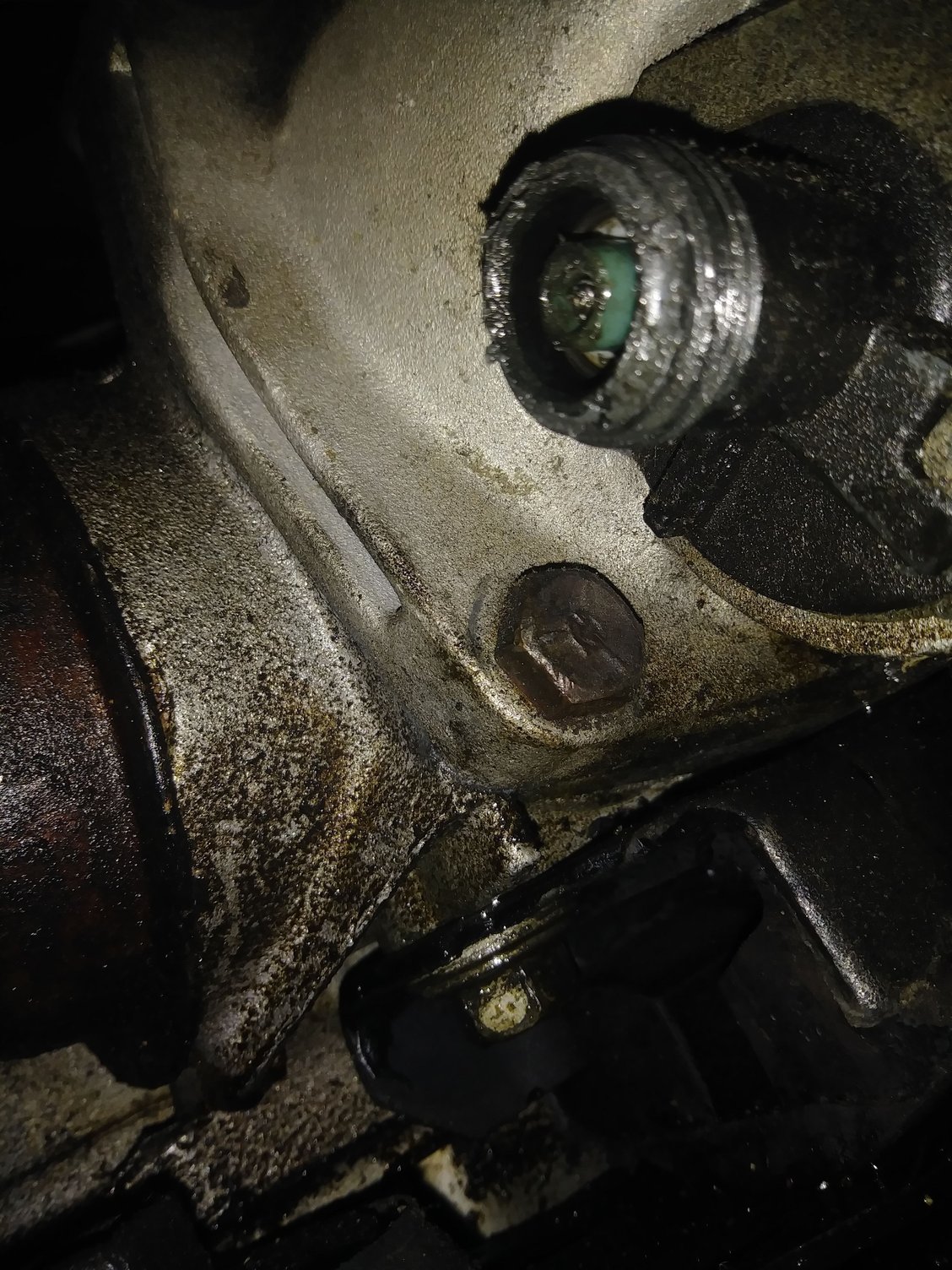

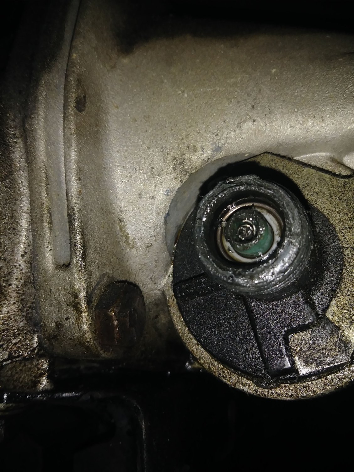

Speedo cable problem
My cable appears to be broken off in the housing any clue how to get it out or what i need to replace ?

You might be looking at a new Gear. You can pull it and could the teeth I think green cane in 42 & 45

I know its a 3.23 rear so i belive thats green. Also if i pull the housing and gear will the trans fluid leak out ?

Yes , but it should be that much.

Grab a rare earth magnet, tweezers, or needle nose pliers and try to pull the old cable spur out of the gear. Might be able to poke it out with a wire from the back side, but I'm not sure the hole goes all the way through.

I tried to pry it out with a small flat head and needle nose pliers but only got a couple little parts. Im gonna take the housing off in the morning and see if im able to poke the rest of it out from the back of the gear

I don’t think the hole goes all the way through

Welp guess I'll still take the gear out so I can count the teeth and makesure I get the right one
